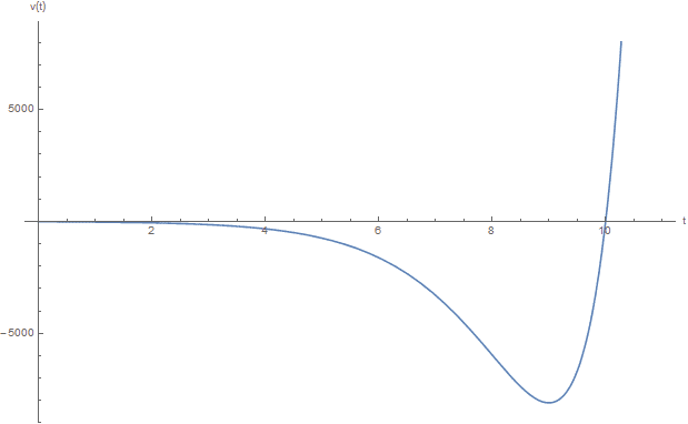

Greetings, fellow PFers,
I have an interesting question which one of my professors raised, and I'm intrigued and would like to try it experimentally, though how to do so isn't clear to me.
Suppose a cart with a constant force on it (say 1N), and with a velocity v(0)=-10 and a mass that changes according to ##m(t)=e^{-t}##. That is, the cart is initially moving in a direction opposite the force. Therefore, the equation of motion gives
##F=\frac{d}{dt} m v = m \frac{dv}{dt} + v \frac{dm}{dt}##
or, solved with the method of integrating factors,
##v(t)=e^{t}(t-10)##
Which, to visualize, gives something like this:
That is, the speed (not velocity) actually increases, before decreasing and the car eventually turning around.

Regarding the equations, I don't think the equation is necessarily correct. It assumes that all momentum is conserved in the remaining mass, which implies that the lost mass has zero momentum at the instant it detaches. It is that phenomenon that gives you your initially increasing speed, because the momentum is getting concentrated into a smaller and smaller mass.
In practice, it seems likely that, leaving aside the accelerating force, the body's momentum reduces in proportion to the loss of mass, because the detaching particles initially have the same velocity as the object, in the object's direction of motion. In that case the equation of motion is simpler: ##\frac{dv}{dt}=\frac{1}{m(t)}=e^t##. Hence ##v=v(0)+e^t## and displacement ##x=-10t+e^t##. In this case the speed decreases right from the beginning until it reaches zero, then heads off in the opposite direction exponentially.

Choose the reference frame where the cart is initially at rest. You have a force in positive direction, and want the cart to accelerate in the opposite direction? The only way to do this, is to shoot off mass forward from the cart, which will create thrust just like a rocket engine.
As andrewkirk shows, It will not work by just dropping the mass with zero relative horizontal velocity.
It basically assumes a rocket engine, with variable expulsion speed, controlled such that the expelled gas is stationary in the frame where v(0)=-10. Due to the decaying mass flow, the negative rocket thrust is initially higher, then lower than the constant positive force.

I presume that by This Effect you mean to refer to the pattern of movement shown in the graph. If so then yes there doesn't appear to be any such experiment without introducing very unnatural system controls such as computerised feedback. But that's because (I think) the graph is based on a mistake. I think that whoever thought up this situation wrote the equation that you solved without realising that it implied that all of the evaporating particles' momentum was magically transferred back to the unevaporated part of the object. I think they were probably just wondering what would be the equation of motion of an evaporating object, wrote that equation without realising that it implied that totally implausible assumption, then observed that it gave an interesting pattern of motion and wrongly concluded that the interesting pattern would be the real pattern of the simple experiment they imagined.
It's only because of the mistake that the pattern of motion is difficult to replicate. The initial idea was simple, and if pursued without the implausible assumption of momentum recapture, leads to an equation, shown in post #3, that should be easy enough to experimentally reproduce, but the mistake turned it into an equation of motion that is unrelated to the initial practical idea, and hence as hard to experimentally reproduce as any randomly chosen complicated function of time.
Having said that, even the original idea is not that easy to reproduce experimentally. I realized that my idea of a hemisphere of dry ice won't give the desired rate of mass loss because the proportional rate of shrinking will increase as it gets smaller, rather than remaining constant as required by ##m=e^{-t}## I think something a little more sophisticated would be needed. eg the dry ice could be in a container with an opening with a variable aperture. The size of the aperture could be controlled by a sliding shutter, whose position is related to the weight of the dry ice by some sort of spring and balance arrangement. The size of the aperture would determine the rate of evaporation. It shouldn't be too hard for a clever engineer to rig up, without needing to involve computer control.
