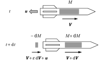

In familiar rocket case
[tex]\frac{d\mathbf{P}}{dt}=M\frac{d\mathbf{V}}{dt}-\frac{dM}{dt}\mathbf{u}=\mathbf{F}_{ext}[/tex]
I assume you say
[tex]\frac{d\mathbf{P}}{dt}\neq M\frac{d\mathbf{V}}{dt}+\frac{dM}{dt}\mathbf{V}\neq\mathbf{F}_{ext}[/tex]
anuttarasammyak said:
In familiar rocket caseView attachment 329995
Isn't this along with post #2 ?
There are two different velocities in the rocket equation. The instantaneous velocity of the rocket and the relative velocity of the expellant. That yields a fundamentally different equation, as explained in the Wikipedia page.

The assumption that ##F=\mathrm{d} p/\mathrm{d} t## were universally valid also for systems of changing mass. If there are parts of the system moving away from it, then it may carry momentum, and this change in momentum has to be added to the force too.
Take the rocket equation. Let the velocity of the exhaust relative to the rocket (which makes it a frame-indpendent quantity) be ##-u##, then you get
$$\dot{p}=m \dot{v} + \dot{m} v=F_{\text{ext}}+ \dot{m} (v-u),$$
where ##\dot{m}(v-u)## is the momentum taken away from the rocket per unit time.
or the Galilei invariant equation
$$m \dot{v}=F_{\text{ext}}-\dot{m} u.$$
For ##F_{\text{ext}}=0## you get the famouls Tsiolkovsky rocket equation,
$$m \dot{v}=-\dot{m} u \;\Rightarrow \; \frac{\mathrm{d} v}{\mathrm{d} m} = -u/m$$
with the solution
$$v=v_0+u \ln(m_0/m).$$
