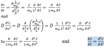

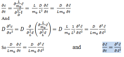

Hi, I've tried what you've advised me, here are my results :
Handwritten derivation of nondimensionalization: x̃ = L^a1 D^a2 m0^a3 x = Lx, c̃ = L^-1 D^0 m0^1 c = (m0/L) c, and t̃ = L^a1 D^a2 m0^a3 t with [D] = L^2/T giving T = L^2/D, so t̃ = (L^2/D) t.
We therefore have:
Handwritten derivation of nondimensionalized diffusion equation: chain rule steps relating dc/dt and d2c/dx2 to scaled variables, ending with D/(Lm0) times dc~/dt~ equals D/(Lm0) times d2c~/dx~2, with the final equality boxed in blue.
For the conditions I found:
Handwritten derivation of a nondimensional mass integral: integral from x=0 to L of c(x,t) dx equals m0, substituted to 0 to 1 of (L/m0) c-tilde d(x-tilde/L), then integral from 0 to 1 of c-tilde d x-tilde equals m0 squared, and c-tilde(x-tilde, t-tilde=0) = 0 for x-tilde not equal to 0.
I'm not quite sure about the integral term though..
