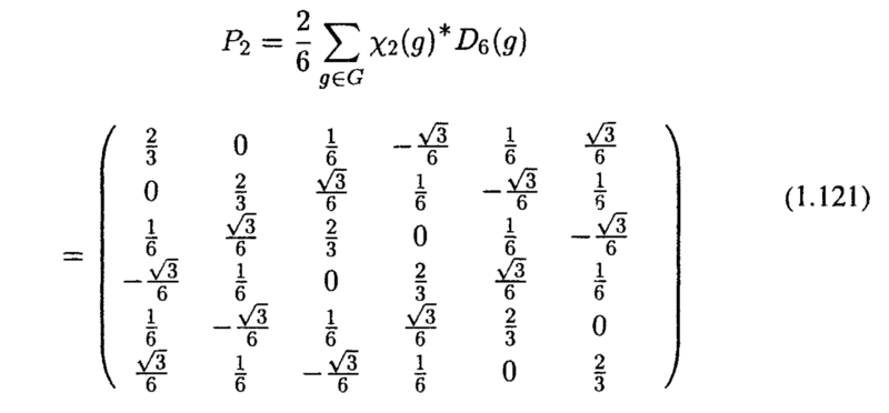

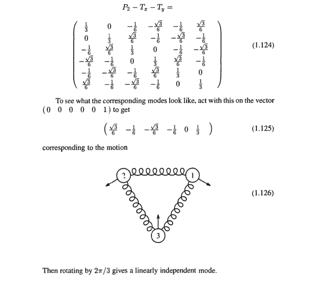

Hello! I am reading some representation theory (the book is Lie Algebra in Particle Physics, by Georgi, part 1.17) and the author solves a problem of 3 bodies connected by springs forming a triangle, aiming to find the normal modes. He builds a 6 dimensional vector formed of the 3 particles and their x and y coordinates and a 6 dimensional representation of S3, as the symmetry of the system. Firstly, can someone explain to me why does the system has a 6D S3 symmetry. I understand you can permute the 3 balls, but I am not sure I understand why changing the x direction motion of one particle with the y direction of another one, is still a symmetry of the system (while keeping everything else the same). Then, he finds the projector operators onto the subspaces on which the irreducible representations act on. The 1D representations appear only once, so finding the normal modes associated to them are easy to find. However the 2D representation appears 2 times and he tries to find the normal modes associated to that. He calculates the projector - P2 - associated to this (P2a.png) and he takes the x and y translations as already known modes and subtract them from P2 and then in order to find the other 2 modes he does the stuff in P2b.png. Can someone explain that to me, please? Why does he pick that vector and why does he rotates it by $2\pi/3$. I assume it is something trivial, but I can't seem to figure it out. Thank you!
It is the system itself that has an S3 symmetry. You can exchange any two of the bodies and end up with the same system assuming that you transform the displacements of the bodies accordingly. For example you can exchange bodies 1 and 2 by a reflection in the vertical line through the position of body 3. This reflection inverts the x-component of all displacements and exchanges the displacements of bodies 1 and 2, which tells you how this symmetry acts on your 6D representation. In effect, you have three displacement vectors that each transform according to an ##O(2)## representation of ##S_3## (let us call it ##\rho_2##) and that are exchanged according to the natural three-dimensional representation of ##S_3## (let us call it ##\rho##), meaning that your 6D representation is given by ##\rho \otimes \rho_2##.
Now, you know that the 6D representation contains overall translations and rotations (as those can be easily constructed by having the displacements of all bodies be the same and by having the displacements being those given by a rotation, respectively). Therefore, your 6D representation will also contain those degrees of freedom. If you are only interested in the vibrational modes of the system, you will need to remove the irreps corresponding to those transformations.
