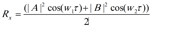

I obtain Autocorrelation function of two signal:
as
[/B]
[/B]
I want to know what is Normalized Autocorrelation of above equation?
Thanks

What have you tried so far?

Sorry if this is a dumb question, but how can you form an autocorrelation between different functions? Can you show your detailed work?
Probably a signal comprised of 2 sinusoidal components.

I used https://en.wikipedia.org/wiki/Autocorrelation on a period of (2pi)
I found out my answer. when we want to normalized our autocorrelation function we should pay attention to Rx(at t=0)=1 to scale the function.
