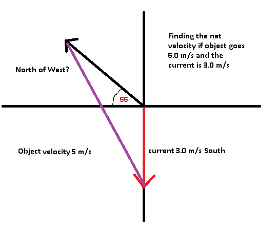

Hi, really I just want to know if I have drawn this out correctly. I have an object with a velocity going North of West.
It is going against a current South. As you can see from the chart I have mapped out the degree the object is heading North of West. How would I find net velocity from this information?
This is what I have drawn so far - would I be solving for the purple line or is this incorrect?
If so, I would need to find the components?
Vy = Vsin 0
and
Vx = Vcos 0
Vy for current is on the negative y axis. So this would end up being -3.0...?
We don't know the distance, but we need to find net velocity, so we can't use displacement.
This is where I get stumped.
Thank you for setting me on the right path!
Does the problem say specifically 55 degrees "north of west"? I don't see that in your statement of the problem but, if so, then your picture is correct. "North of west" without a specific angle measure would be peculiar. "Northwest", alone, specifically means "45 degrees north of west" (which is also "45 degrees west of north", of course).
Also, if you are told the object is going "55 degrees north of west at 5 m/s" then your "5 m/s" should be on the black arrow, not the blue one. Please give the full statement of the problem.

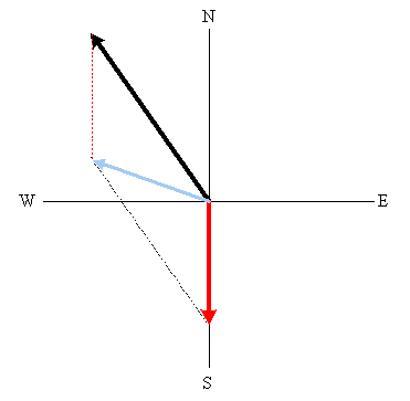

Hi LeighV, Welcome to Physics Forums.
When you want to find the resultant of two vectors that are being added you place the vectors tip to tail or complete the parallelogram, or algebraically sum their X-Y components:

Hi, sorry if I wasn't clear enough. Yes it says 55 degrees north of west. Thank you. The blue/purple arrow was just one I added into try and figure out if that was what I needed to answer (find the value for), the black arrow represents the direction not necessarily the speed. Thank you for your response!

Thank you! So what does the purple arrow in your diagram stand for? Is that what I need to find or is that represented by those dashed lines?

LeighV, the graphic addition of your vector was already explained above, by gneill.
Now, to do it 'analytically', you should start by stating the vectors: you have, for example, v (the velocity of the object in the current), w (the velocity of the current with respect to the shore, or to distant, non-moving waters...). And -as you want the sum of those two vectors- you should start by splitting into components. You are in the plane, with two dimensions, and your vectors are defined by its two components, horizontal and vertical.
Yes, the purple arrow is the resultant of the the velocities being added (Black and Red vectors).
