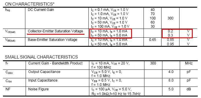

This is a clip from a 2N3904 data sheet.
Note the marked values for Vce and also the very low gain of the transistor at saturation.
Ic is only 10 times Ib.
Also in the next line, see the base voltage at saturation. Nearly a volt.
Are you saying that the 3904 requires a volt to the base to fully turn on?
It seems counter intuitive but the Vce sat can be very low, indeed - less than Vbe (which is weird).
Vbe can also be very high but there's no point in running it that way if all you need is 20mA! Saturated 'enough' (?) is all you need.

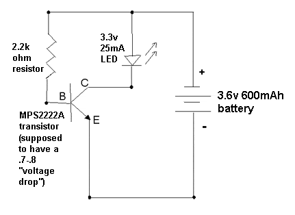

Maybe I can make this easier... on a little hobbyist site, there is a circuit using MPS2222A transistors, and it states that these have a ".7 - .8 voltage drop across them" and that has to be taken into account upon circuit design. Below is a simple circuit showing what LEDs and battery I have and puts the transistor to work:
But I'm afraid that the LED won't light up fully because of this ".7 - .8 voltage drop"; and instead of getting 3.6V, getting ~2.8V or something.
Luckily, I have a bunch of spare transistors, including the 2N3904, and maybe if this MPS2222A won't work right, maybe one of those will have a lower voltage drop and I won't have to go buy MOAR parts. o_0
Use a 1k resistor in the base instead. That should give more base current which should increase the Collector current and give less Vce drop. The LED should get a bit brighter.

Hm. Why would using a resistor a little less than half than the one specified decrease the voltage drop of the transistor? Just curious. Lucky for me I have some 1k ohm resistors! =D
If that doesn't work there's always the option of using an LED that requires less voltage like you said; from my calculations an LED between 2.8V and 3.25V would work (probably is a yellow one).
