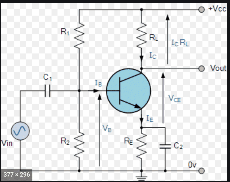

1. Why is a dc component added to the input signal?
2. In the diagram below of a common emitter BJT used as an amplifier, how is Vbb kept independent of Vin?

2.In the diagram, what I don't understand is why have they not shown a constant voltage source ##Vbb## for biasing? The ##V_b## in the diagram refers to ##V_{BE}##, right? That apart, what I am confused about is how do they ensure that ##V_{in}## does not affect the biasing ##V_{BB}##?!
3. In the third question I am unable to understand why an increase in ##V_{CE}## causes a decrease in ##I_B##.
4. Also, I don't understand how the amplifier action works.
When biased in the active region the collector draws electrons from the emitter and a minuscule fraction of those electrons go towards the base terminal giving rise to the base current. Thus the relation can be derived that a small base current corresponds to a very large emitter or collector current.
What I fail to see is where the input signal comes into the picture? Does the input signal cause an increase in the base current and thus an increase in the collector and emitter currents? If so, I don't understand how an increase in base current causes an increase in the emitter or collector currents. I understand mathematically that since α or β have high values, a slight increase in IB would mean a large increase in the collector or emitter currents. However practically it seems that the base current is simply a part of the collector current which branches away and so an increase in base current could be allowed by having a smaller emitter current...
The amplifier in the diagram is a practical one. There is only one source (Vcc) used for dc biasing. The Vcc>> R1>>R2 network is called voltage divider bias (one of the biasing techniques).
Also, the RE in the circuit is for thermal stabilization. I think you are considering too many things at once which is resulting in confusion.
I would not recommend that diagram if you want to learn amplifiers from scratch. Also, it is difficult to teach amplifiers in a forum thread.
