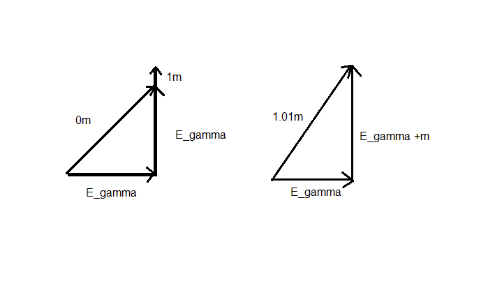

I think I may have solved it. I made a diagram.
Using the second portion
[itex](E_{\gamma}+m)^{2}-(E_{\gamma})^{2}=(1.01m)^{2}[/itex]
[itex]2E_{\gamma}+m^{2}=1.0201m^{2}[/itex]
[itex]E_{\gamma}=0.51005m[/itex]
This seems to make sense but I am not sure if it is correct.
I'm not really familiar with that kind of diagram. But the solution looks correct.
