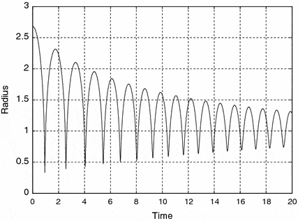

I have been trying to find a numerical solution to the Rayleigh Plesset equation (for a sonoluminescing bubble) using a Python code. Read up here if you need to refresh on this (surprisingly) unknown field: https://en.m.wikipedia.org/wiki/Sonoluminescence
However, the python code seems to give a strange output. Please, gods of computational physics help me...
I have been trying to numerically solve the Rayleigh Plesset equation:
$R\ddot{R} + \frac{3}{2}(\dot{R})^2=\frac{p_g-p_0-p(t)}{\rho_l}-4\mu\frac{\dot{R}}{R}-\frac{2\gamma}{\rho_lR}$
using the odeint python function. The code is given below:

en i run the code, I get a very strange output.
It should look more like this:
Line graph of Radius against Time from 0 to 20, showing a bubble radius that repeatedly drops toward about 0.5 and rebounds, with the peaks gradually decreasing from about 2.7 to about 1.3.
[1]: https://i.stack.imgur.com/aTc3j.png
[2]: https://i.stack.imgur.com/fQ9J8.gif
EDIT:
Ok, I've been working on the code for a while, and I think I have found the mistake. I was using an approximate form of the equation. For anyone interested in the correct code, here it is (feel free to edit it if you want, I am bad at writing efficient code XD).

I rescaled the axes so that the marks wouldn't overlap, and the results should coincide with past literature.
  • Line graph of Radius against Time from 0 to 20, showing a bubble radius that starts near 2.7, drops to about 0.3, and then oscillates with decreasing amplitude, settling between roughly 0.7 and 1.3.
