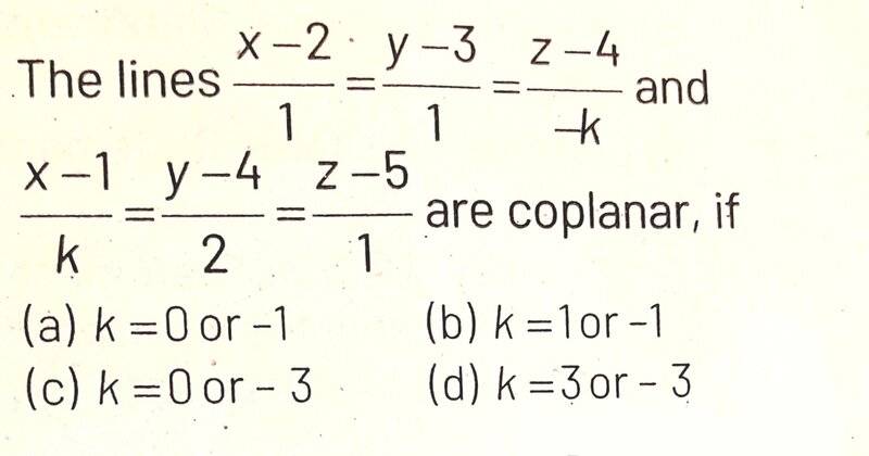

Multiple-choice problem: lines (x-2)/1 = (y-3)/1 = (z-4)/-k and (x-1)/k = (y-4)/2 = (z-5)/1 are coplanar if; options (a) k = 0 or -1, (b) k = 1 or -1, (c) k = 0 or -3, (d) k = 3 or -3.
So I tried to solve it this way:
The equations of the lines in vector form are
$$(x-2)\hat i+(y-3)\hat j+(z-4)\hat k=\lambda (\hat i+\hat j-K\hat k)$$
$$(x-1)\hat i+(y-4)\hat j+(z-5)\hat k=\mu (K\hat i+2\hat j+1\hat k)$$
Since the lines are some real multiple of the vectors,
For coplanarity $$(\hat i+\hat j-K\hat k)\times (K\hat i+2\hat j+1\hat k)=0$$
Therefore, ##2-k=0; -k^2-1=0; 1+2k=0##
So no solutions should exist, right?

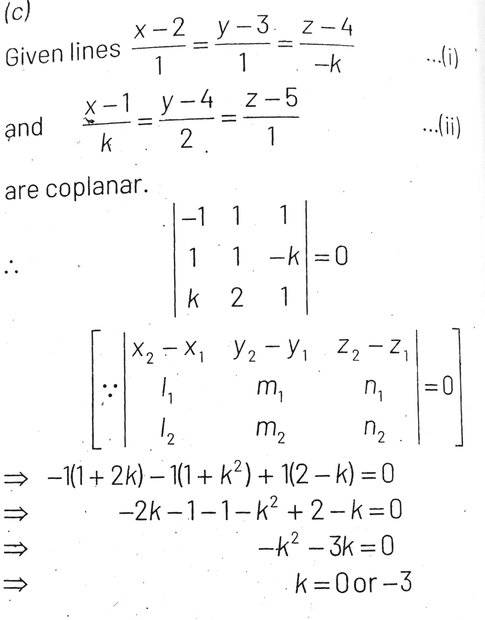

But the book and some websites solve it thus
Handwritten solution: condition for two lines to be coplanar, the determinant of the matrix of differences and direction ratios set to zero, giving k = 0 or -3.
So where and why did I go wrong??
Yhe only way the cross product of the tangent vectors will vanish is if the lines are parallel, which is not what was asked for.

If [itex]\mathbf{x_0} + \lambda\mathbf{n_0}[/itex] and [itex]\mathbf{x_!} + \mu\mathbf{n_1}[/itex] lie in the same plane, then the normal to that plane must be [itex]\mathbf{n}_0 \times \mathbf{n}_1[/itex]. However, a line drawn between a point on one line and a point on the other - such as the line from [itex]\mathbf{x}_0[/itex] to [itex]\mathbf{x}_1[/itex] - must also lie in that plane, so we must have [tex] (\mathbf{n}_0 \times \mathbf{n}_1) \cdot (\mathbf{x}_1 - \mathbf{x}_0) = 0.[/tex] The determinant in the given answer calculates this triple scalar product.

In 3D, there is also the possibility that the lines are not parallel and do not intersect, in which case they are not coplanar. If they intersect or are parallel, then indeed they are coplanar. Here the OP has shown that the lines cannot, in fact, be parallel - but depending on [itex]k[/itex] they might not intersect.

Since it is multiple choice we could cheat by trying out the offered solutions.
For the lines to be coplanar they must either intersect or be parallel (=intersect at infinity).
If k=0 is a solution then immediately z=4 and x=1, which both lead to y=2. Thus k=0 is a solution.
With k=-1, z=y+1=x+2 and x=6-z, contradicting intersection. Since the disagreement extends to the magnitude of the ratio of the x and y coefficients, we can also rule out the parallel case.
That leaves only option c.
