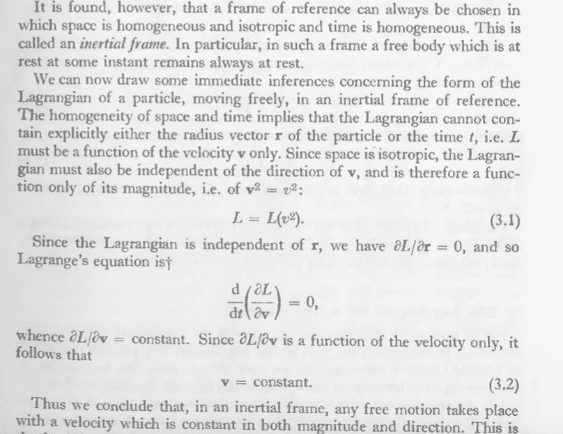

How do we deduce the conclusion of (3,2)? This is a topic inertial frame.
Law of inertia
I understand that d/dv(L) = constant, and L is only dependent on v, but how do we get to the fact that v = constant?
Say
[tex]\frac{\partial L}{\partial v}=f(v)[/tex],
[tex]\frac{d}{dt}f(v)= \frac{df(v)}{dv}\frac{dv}{dt}=0[/tex]
Usually ##\frac{df(v)}{dv} \neq 0## so
[tex]\frac{dv}{dt}=0[/tex]
