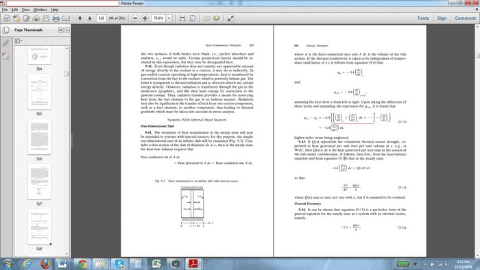

Hi There,
I came across the following passage in Sam Glasstone's 'Nuclear Reactor Engineering'
See where I underlined in red that taylor series expansion? I don't understand how (dt/dx)_(x+dx) is equal to that.
I know it's a Taylor series expansion, but where did the x+dx go?

Well,
I know it's the incremental form of the Taylor series:
http://geophysics.ou.edu/solid_earth/readings/taylor/taylor.html
But I have no clue how to derive this incremental form.
The differential is supposed to be small, so we can neglect higher order terms in the Taylor series expansion since squaring a small number will give you an even smaller number. So you have heat entering and exiting your differential control volume,
That is Net Heat Flow:
qx- qx+dx.
See the heat enters at position x and leaves at a position x + a very small amount (dx). Now if we do a Taylor series expansion
qx+dx= qx +(dqx/dx)*dx
Take this expression and substitute into the above expression for net heat flow.
qx-qx+dx=qx-qx+(dqx/dx)*dx
Then:
qx-qx+dx=(-dqx/dx)*dx
No you can't cancel those two dx terms because one is a partial differential and the other is total. The one in parentheses is the partial differential.
Now we can describe qx using Fourier's law
qx=-kA(dT/dx).
Substitute this into our above expression
-d/dx*(-k *dydz*dT/dx)*dx
Net heat flow in x direction is now
d/dx*(kdT/dx)*dxdydz
The area in the x direction is given by y times z, similarly in the y direction area will be given by x and z
If you do those equations for the y and z directions and then divide the whole equation by dxdydz you will obtain the heat equation.
I assume you were ok with the other terms in the heat equation. If not I'm happy to explain the derivation of those as well

I looks like a Taylor series expansion for the first derivative instead of the function itself.
The Taylor series expansion for function "f" about x = 0 is:
f(x) = f(0) + df/dx dx + 1/2 d2f/dx2 (dx)^2...
In this case, the function f is dT/dx; so all the derivative are one degree higher.
Greg
