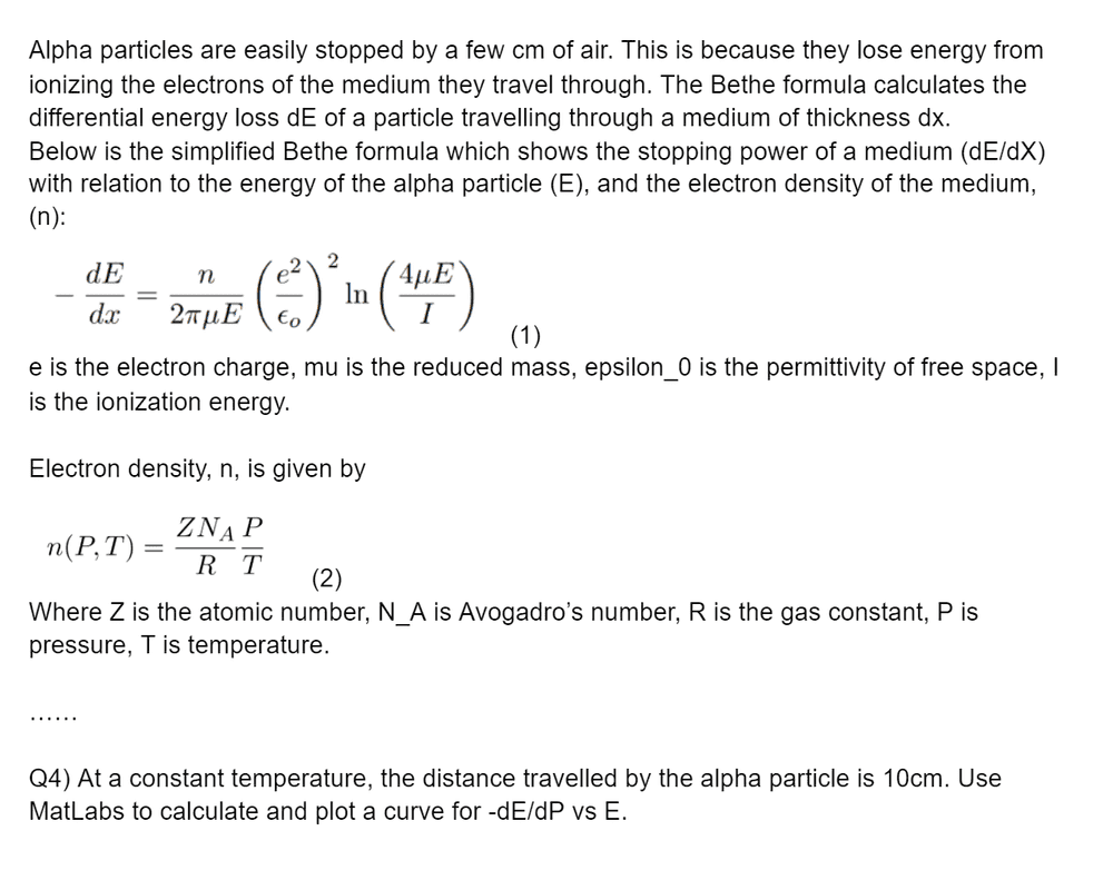

PandaKitten
-dE/dx = A*(n/E )*ln(E)
n=P/T
Find dE/dP
Where T and A and dx are constants. E and P are variables
n=P/T
So first thing I tried was to separate the variables then differentiate by parts, setting u = E and v = 1/ln(E) (and the other way around) but I couldn't do the integral it gave.
Then I tried to reason that because dx was constants then dE/dx is equal to E/x but I was told that's not the case. The lecturer also mentioned the truncated series for a Taylor expansion but I'm not exactly sure how that is relevant
I'm confused how the thing on the right relates to x. What does it mean for dx to be a constant?
In general if you have ##dE/dx=C## for some constant C, then integrating gives you ##E=Cx+D## for an arbitrary constant ##D##. I can't tell if you're trying to say that's the situation you're in.
The first equation works out the rate of decrease of energy with distance -dE/dx of an energy emitter. But in this question, we are at a fixed distance from the energy emitter. So it wants us to write it in terms of dE/dP instead where P is pressure (second equation). Let me know if it is still unclear. Sorry if this doesn't make sense
We're at a fixed distance from the emitter so dx is constant**
Would you provide the problem as it was assigned?
The question sheet includes a lot of background information and other questions. Below is a summary.
Typeset text with two equations: simplified Bethe formula for -dE/dx = n/(2πμE) (e²/ε₀)² ln(4μE/I), labelled (1), and electron density n(P,T) = ZN_A P/(RT), labelled (2).
You'll need to solve a differential equation for E and x to compute E at x = 10.
You might need a numerical method for this. The Taylor expansion could also be used here (if the error is small enough). This E will of course depend on P, so you can calculate dE/dP. This might have to be done numerically also.
Be careful, when E gets small enough, the ln changes sign, so there is something else that has to be brought in.

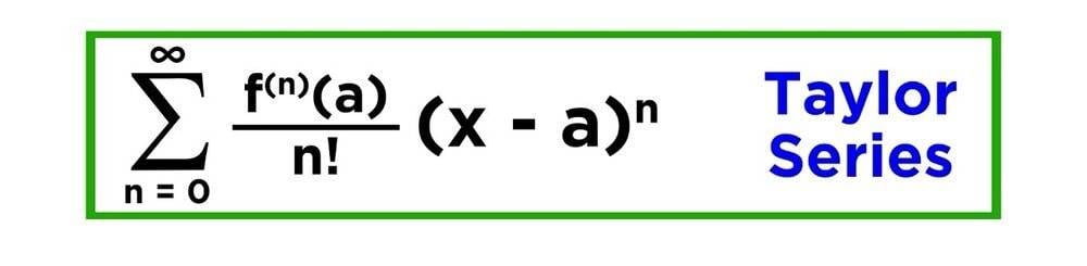

How would I solve it using the Taylor expansion? Would I use this formula and set X= 10cm?
Taylor series formula: sum from n = 0 to infinity of f^(n)(a) divided by n! times (x - a)^n, with the label Taylor Series in blue text.
