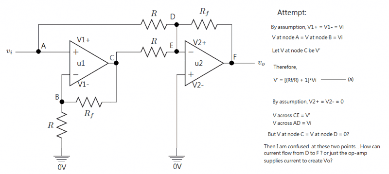

This discussion centers on the effective analysis of operational amplifier (op-amp) circuits, emphasizing the superiority of nodal analysis over basic gain formulas. Participants agree that while formulas like inverting gain (-Rf/Rin) and non-inverting gain (1 + Rf/Rin) are useful, they can lead to confusion in complex circuits. The consensus is to prioritize understanding nodal analysis, which simplifies the derivation of these formulas and ensures accuracy in circuit analysis. The discussion highlights the importance of recognizing node potentials, particularly between nodes D and E, which are identified as the same due to their shared voltage.
