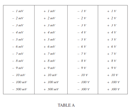

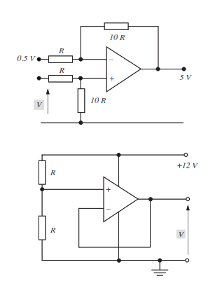

FIGURE 1 shows two amplifier circuits, each of which has one unknown
voltage (shown highlighted). Select, from TABLE A, the most
appropriate value for the unknown voltages for each circuit. Assume that
the op-amps are ideal and that the magnitude of their output voltages is
less than their maximum peak output voltage swing (VOM).

Two op-amp circuit schematics. Top: inverting amplifier with 0.5 V input, feedback resistor 10 R, input resistors R, a 10 R resistor to ground at the non-inverting input, and output labelled 5 V. Bottom: voltage follower with +12 V supply, two R resistors in a divider, and output labelled V.Table A, a four-column list of voltage values in mV, V and combinations such as -1 mV to -500 mV, +1 mV to +500 mV, -1 V to -300 V and +1 V to +300 V.Hi - I have made an attempt at both of these circuits, but I am not 100% sure I am correct. Would it be possible to check if I have this right, and if not, please give me some pointers as to where I have gone wrong? Thanks
First op-amp
Given data:
Vo = 5V
I have called the voltage feeding into the non-inverting input V1 = 0.5V
voltage feeding into the inverting input = V2
For non inverting input V+ = V1/(1+10)
For inverting input V- :
(V2 - V-)/R= -(Vo - V-)/10R
V2 - V- =(-Vo + V-)/10
10(V2 - V-)-V- = -Vo
10V2 - 11V- = -Vo
Plug in values
(10*0.5) - 11V- = -5
-11V- = -10
V- =10/11 = 0.909V
As it is an ideal op-amp:
V+ = V- = 0.909V
Therefore:
V+ =V1/(10+1)
V1 = V+ * 11
V1 = 0.909*11 = 10V
Second op-amp
At non-inverting input:
V+ =Vo/(R+R)
V+=12/2=6V
V+ = V- =6V
Due to short from inverting input to output, output voltage (V) is 6V
You are relating the non-inverting "feeding" voltage (V1) to the actual voltage at the non-inverting node (V+) right?
In that case, you have incorrectly applied the voltage divider formula here.
Yep that's what I was trying to do. What have I done wrong with the formula?
Your V+ is the voltage across 10R.
The total series resistance is 11R.
How are V1 and V+ related then?
So should it be
(0.5-V2)/R = (V2-5)/10R
No.
You have input voltage V1 and two series resistances R and 10R forming a voltage divider.
What fraction of V1 is dropped across 10R?
You have calculated that fraction. You need to find V1 from that fraction.
cnh1995 said:
No.
I see - so it is 10/11?
peasngravy said:
V1= 10/(11*0.91) = 0.99V?
Sure, but if you keep all the terms in fraction form till the end, you will get V1= 1V, which is the accurate answer.
Thank you so much for helping me to understand.
Does the second op-amp look Ok to you?
Yes 6V looks correct to me.
Thanks again for your help
If the circuit is working (ie the amp is in its linear working range and the output is not driven to either rail voltage) then the difference between the -ve and the +ve inputs will be Vout / Amp gain. As the Amp gain is very, very high, the difference will be effectively zero. That is why they are called "virtual Earth's".
The input resistance (actually impedance) of the amp will be very, very high so you can ignore it.
Everything else then follows.
Then do a final check - do the voltages you calculate give the output voltage?
