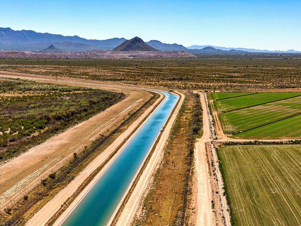

what dynamics are moving liquid in open channel flow without slope (irrigation channels)? Are they mostly hydrostatic forces?
imagine 2 scenarios
1. Channels are empty and are being filled for the first time. What forces drive the liquid until it becomes big static lake?
2. Channels are filled but at the end of the channels water is being pumped out for irrigation. What drives the liquid to be replenished in the channels?

Open channel flow is purely gravitational.

Gravity
Gravity
Again, open channel flow is purely gravitational.

1. At the point you are filling the channel the water surface is raised a bit. Gravity will even this out by moving water away from this point.
2. vice versa.

I'd say no, as hydrostatic force (force due to hydrostatic pressure) is the force on a submerged surface or parcel of water due to the height of the column of water above it (its depth). To drive flow from one place to another, you need a difference in height of one column of water to vs another at another place (not depth). That's called hydraulic or gravitational head:
https://en.wikipedia.org/wiki/Hydra...r piezometric head,or bottom) of a piezometer.
Related, but not quite the same thing. But it's this difference in height (and the resulting pressure difference) that drives the flow.
