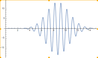

Here simple integration won't help, because the integral depends on where in the cycle we start from. If we integrate a positive half-cycle first and then a negative half-cycle, we get a negative result, and vice versa. To avoid favoring either the positive or negative half cycles, we can multiply our function by a window function:
And now if we integrate over the window we can retrieve the bias (average) of 0.1.
