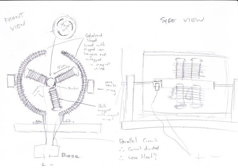

Btw, this is my current design:
For full res: http://i.imgur.com/huDRz.jpg
Makes little sense to run a motor on such low volts. The resistive losses would be excessive. What's it for? Why are you creating such a specification?

How is this design of yours, above, supposed to work?

WELL.. umm...ummm..The shaped galvabond sheets encompassing the armature are supposed to act like radial electromagnets. The steel hangers lined on the sheet and wrapped with the copper wire are supposed to act like an iron core (since the galvabond is being a bastard =_=). Therefore, the actual sheet is only supposed to act as a frame, so the whole thing doesn't fall apart. The coils of one plate, will be connected to the positive terminal, whilst the other, the negative terminal. This should create opposing fields (I'm so rusty at this stuff D:). When a current is run through the wire, it should become a magnet xD (*fingers crossed*) EDIT: LETS ALSO HOPE IT DOESNT MELT! DX
As for the armature itself...its pretty much normal (although excessively huge xD), except that its got three splits (120º each) on the commutator to match the three poles of the armature. I'm using carbon brushes designed for 12V, but let's hope itll work on at least 6V. :S
The whole thing is connected to a transformer/power supply which can provide voltages of 2-12V. The perma mags are for back up xD.
Let's hope it works! :D

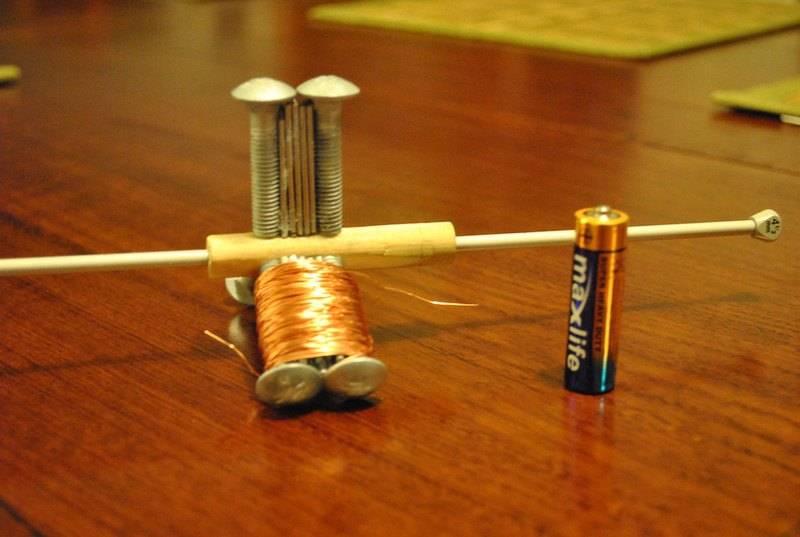

Oh btw here's how its going so far:
AA Battery for size reference.
I also added clipped hangers in between the bolts because I've got OCD :D well and because they're good cores, but I hope they didn't add too much weight. They're really light, but the armature is not xD

Once one pole of the armature 'locks' with the opposite pole from the fields of the stator, why would it rotate any further? I presume we're talking a DC current here?
Umm this guy can explain it heaps better than me xD
Go to 4:39
Sure, his diagram looks just fine. But you appear to have coils around two cores that would only produce magnetic fields right at the ends of those two arcs. You need the 'N' field for most of one side, and S field most of the other. Your coils (if I understand your diagram) would produce mag fields only across the gap at the very top and bottom of the drawing.
Okay I'm officially confused xD What do you mean by 'two arcs?' [EDIT: Oh do you mean the electromagnets?] :S The coils weren't completed in the picture, and the commutator is supposed to be on the empty right hand side of the dowel, if that solves anything xD I can always centre/shrink my electromagnets on the two cores, the diagram was just a quick one i did in 2 minutes lol.
Could you please explain again, with diagrams :D? I'm not following... D:
Oh btw, if I connect both ends of the coils of one of the electromagnets to the same terminal, and the coils of the other electromagnet to the other terminal, would that short circuit?
ITS ALIIVVVVEEEE! :DDDDD
...although I've only tested it with perma mags xD I have yet to complete my electromagnet 8D
