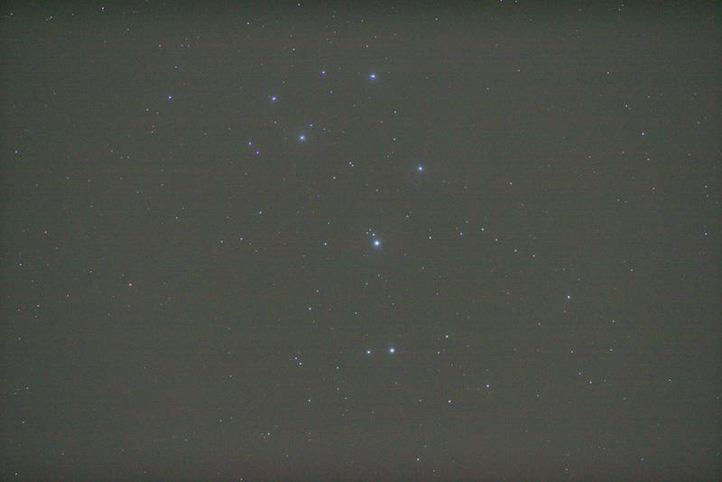

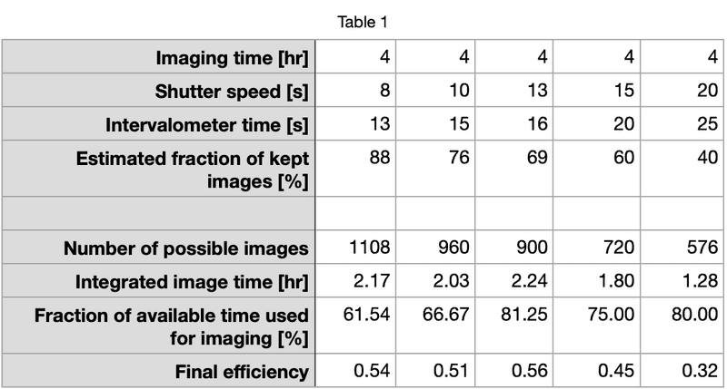

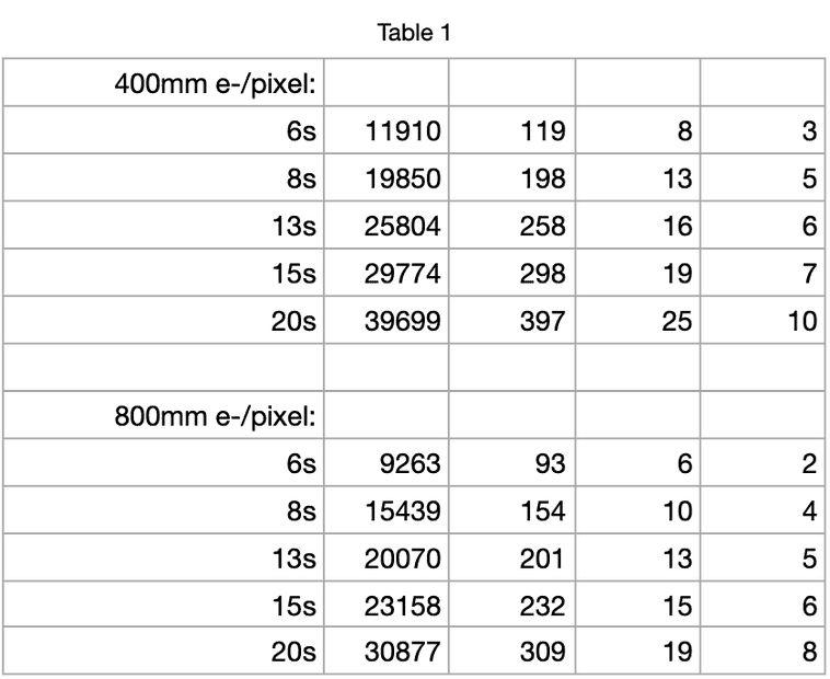

I'm hoping there's a reasonable answer to this. To summarize, data I acquired when imaging a particular target shows that I can retain 75% of my images for stacking at 10s exposure times, but only 50% of the images taken with 15s exposures. The difference is entirely due to tracking error and no, I am not going to get an autotracker.
Possibly the most important metric (for me) is 'efficiency': what fraction of the total time I spend on any particular night, from setup to takedown, consists of 'stackable integration time'. Factoring in everything, 10s exposures results in an efficiency of 50% (e.g. 4 hours outside = 2 hours integration time), while 15s exposures gives me a final efficiency of 40%.
It's not clear what's best: more images decreases the noise, but longer exposure times increases the signal so I can image fainter objects (let's assume I never saturate the detector). More images means I can generate final images in fewer nights, longer exposures means I have fewer images to process to get the same total integration time.
For what it's worth, in my example I would obtain 480 10s images or 303 15s images per night. My final stacked image would likely consist of a few thousand individual images, obtained over a few weeks.
I haven't seen a quantitative argument supporting one or the other.... thoughts?

Part of the reason I am thinking about this because when I look back to when I started astrophotography, my efficiency was around 5%. No tracking mount meant that the exposure time was only 0.5s but I kept nearly every single frame; I could just barely make out magnitude 12 or 13 stars. Currently, I am able to reliably image stars of magnitude 18 or 19 using the same camera and lens.

@Andy Resnick Suffice it to say, your best bet is to try both methods and see which one works better. My personal opinion is any possible benefit to switching to slightly longer subs is negligible and you'd be better off getting a new mount or some other means of increasing your exposure time to a minute or more. With 10-15 second exposures your readout noise is an appreciable fraction of your shot noise for targets of moderate brightness (based off some calculations from an image of the Omega Nebula I took).
Details: 300 second sub. I chose a random pixel from a semi-bright region of the nebula and obtained a pixel value of about 2000. I then subtracted the sky background and bias of about 700 to obtain a signal of 1300. I then divided that by 20 to obtain the same signal as a 15 second sub. That gave me 65. The noise is then the square root of this, or 8.
Of course those are pixel values, or ADU's. We want to know electrons. My camera has a gain of 0.19e/ADU, so converting the noise to electrons yields a noise of about 1.52e. Compare this with the listed readout noise of 5e and you can see that even a modern, specialized CCD sensor is still dominated by readout noise at short exposure times.
Simply increasing exposure time to 1 minute would result in a shot noise of 16 ADU's, or 3.04e, and 2 minutes to 4.33e, a drastic improvement since we want readout noise to contribute as little as possible relative to shot noise.

Right- which is why I came up with the 'efficiency' metric. I was hoping there was some quantitative justification for it, is all.
