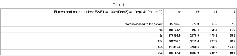

I first asked (what I thought) was a simple question: how many (visible band) photons emitted by a distant star are absorbed by the sensor per second? I used a combination of blackbody radiation (standardized to the sun: 43% of the emitted light is visible, the solar constant is 1361 W/m^2) and the relationship between flux and magnitude to generate a table like this:
And then convert to e-/pixel based on the (measured) FWHM size of the airy disc and assuming 50% quantum efficiency:
The next problem was to determine the amount of noise present. I gave up on this, because the specifications are not available and what I could find online was not really trustworthy (IMO). If I had to, I would estimate the total noise somewhere between 8 e- and 12 e-.
But- what I can see is that, for example imaging @ 400mm, that a magnitude 18 star should be well-separated from the noise even with 13s exposures. Not so much at 800mm, which will require longer exposures, but I can still comfortably image magnitude 16-17 objects at exposure times I can manage (typically 8-10 seconds)

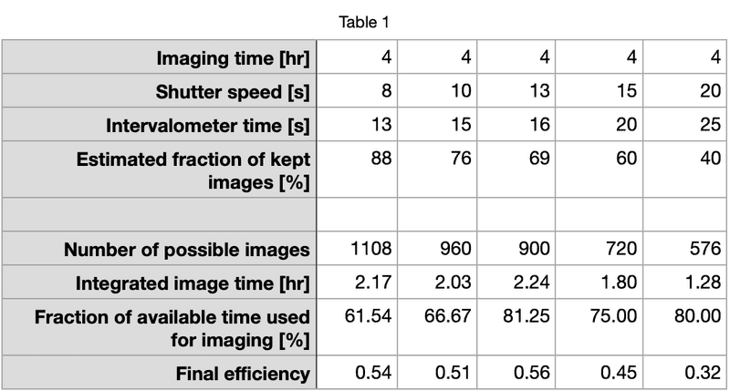

So that brings me back to my efficiency calculation: given 'H' hours acquiring images, what fraction of those images are retained for stacking? That gives me a scond table:
So what I conclude is that, at 400mm imaging, I am better off exposing for 13s rather than 20s- the increased number of images results in a lower variance of the background.
So that's what I tried: imaging at 13s ISO 200 instead of 20s ISO 64 (also: lower read noise at ISO 200 compared to ISO 64, something I don't understand....)
The resulting stacks (comparing 20s subs and 13s subs), both with equal total integration time, showed that the two stacks appear nearly identical. This was confirmed with image analysis. The major distinction is that the 13s stack had a lower variance (which is what I wanted- easier to separate out light pollution).
Anyhow.. thanks to everyone for their comments, this has been educational!
