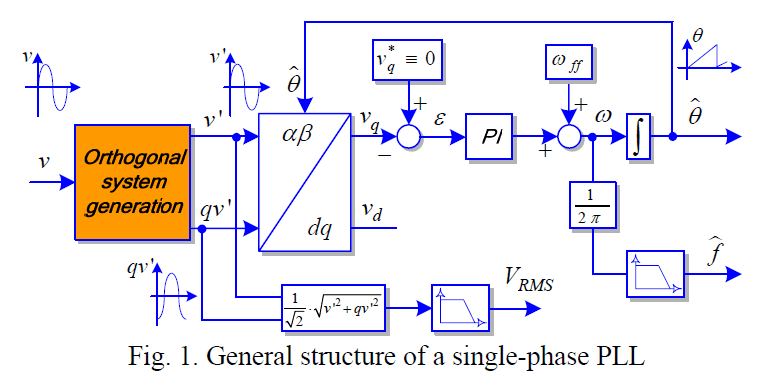

Hello,
I've written a program that executes the following control diagram.
Now I am trying to calculate the PI controller gains such that I can achieve a settling time of 0.06s and a damping factor of 1.
How can I do this?

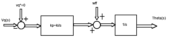

I tried sketching a control diagram of the relevant portions.
Any suggestions/comments/advice would be greatly appreciated.
Thanks!
In the latter diagram you are missing the feed-back loop ( from Theta(s) to Vq(s) ).
Use Masons rule to find the closed-loop transfer-function ( and the characteristic equation ) of the system.
Create root-curves, varying kp and ki using some computerprogram (CAD), until the characteristic roots fits your specifications.
Advice: Use z-transform instead of Laplace-transform, as z-transform calculates correctly despite discreet and time-delayed calculations.

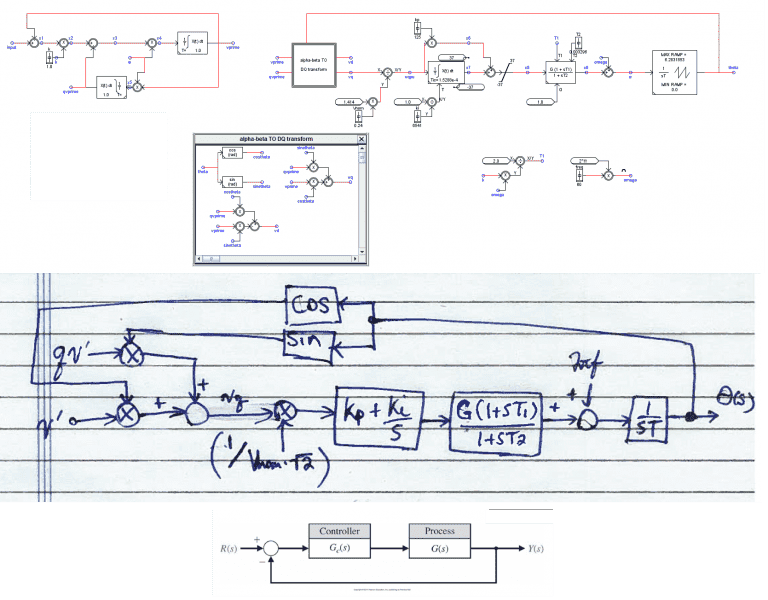

Hi,
Below I've included a more detail diagram of the controls, and another sketch of the control diagram.
If I can convert this into something similar to the diagram shown at the bottom of the figure, then I can do some analysis such as root locus or by using MATLAB to make a sensible choice for kp and ki given the constraints. But how can I get it into this form?
I don't quit understand what you mean by "get into this form", but anyway:
In your diagram, drawn by hand, I can count about 1 zero and 3 poles (3. order system), and as such you must have 3 tuning-possibilities. You can add an extra zero in your controller, thereby having a PID-controller to comply with your specifications.
Generally having a control-loop with forward feed = A(s) and backward feed = B(s), Masons rule says that the transferfunction of the whole system will be:
y(s)/u(s) = A(s) / ( 1 + A(s)*B(s) )
Setting the denominator = 0, you have the characteristic equation, giving the characteric roots at different values of kp, ki, kd. Now keep two of the values fixed while varying the third (iteratively). It's a "cut and try" proces, which ( after some training ) can be done in 5 minutes.
Note: If your tuned system is not physically doing exactly as intended, the cause may be that you are using Laplace-transform instead of z-transform!
Hello,
I've still been working on this problem for the past couple days and feel as though I've better expressed my concerns in the post below.
Let's start over.
Evening gents,
I wrote a program that executes the following control diagram. The contents of the orange box titled, "Orthogonal system generation" is shown in the lower part of the Figure as indicated by the black arrow.
http://forum.allaboutcircuits.com/attachments/pll-png.84178/?temp_hash=ce17ff051d9277ae54c53e5790ad0dfb
I did some analysis by hand to better understand how this control diagram works and have attached my scribbles, but I still have some unanswered questions.
  1. I've read in several other papers that the output of the PI controller is \Delta \omega. In my analysis I found that the input error signal to the PI controller was, \epsilon = V_{m} ( \phi - \hat{\phi} ), and I cannot figure out how this becomes \Delta \omega at the output. Any ideas?
  2. In the PI controller the output of the integrator in the integral path has a limiter at the output. What I'm confused about is how one should set these limits. Through experimentation with my program, I found that these limits will limit that amount of frequency deviation you allow in the output frequency signal \omega. This in turn affects the speed of the response for the controller when the phase of the input signal given undergoes a step change. The more frequency deviation you allow (i.e. the larger your limits are) the faster the response of the controller (i.e. it will lock onto the phase of the signal faster). However, as a trade off for faster controller response, one observes more deviation in the frequency signal \omega. Is there a way I can do some analysis to robustly determine how these limits affect the performance of the controller? Some guidance is all I'm asking for.
Thanks for all your help!

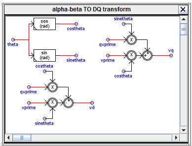

what is in the block that ouputs Vq

Also, the portion inside the block that outputs Vq is a Clarke to Park transform. It looks like this,
