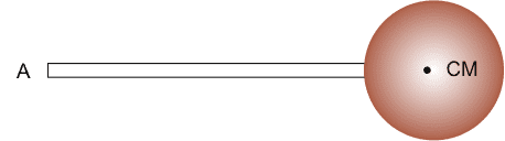

OK, let's say you have a spherical lollipop with a very light handle so that the CM is essentially at the center of the sphere. You want to set it in motion so that it does what?

I am not sure what you mean by "backwards". Here is a picture of a lollipop in space. Please explain how you define the forward and backward direction in terms of "up", "down", "left" and "right" as related to the figure. I have labeled the tip of the stick as "A" and the center of mass as "CM".

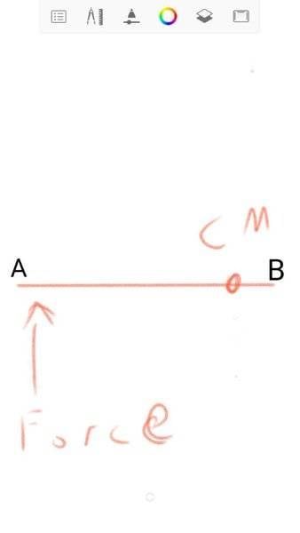

I want to know the optimal position for cm in order for point "B" to initially go "down" when force is applied at point "A"

Let me rephrase your question:
When you give an impulse to one end of the rod, the COM moves forward and the object rotates around the COM. The initial velocity of the other end if the rod is the sum of the forward velocity of the COM and a backwards velocity from the rotation.
Question: what mass distribution will result in the other end of the rod initially moving backwards from its starting position with the greatest speed?
Suggested simpler version: you have a uniform rod of mass ##M## and a mass ##m## that can be attached to the rod at any point. Where do you attach the mass ##m## to maximise the backwards speed, as above?
How much of this can you work out for yourself? Do you know about the moment of inertia?

It turns out you want all the mass in the middle of the rod.
