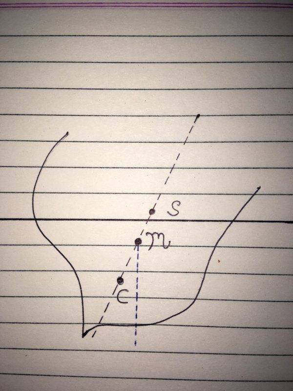

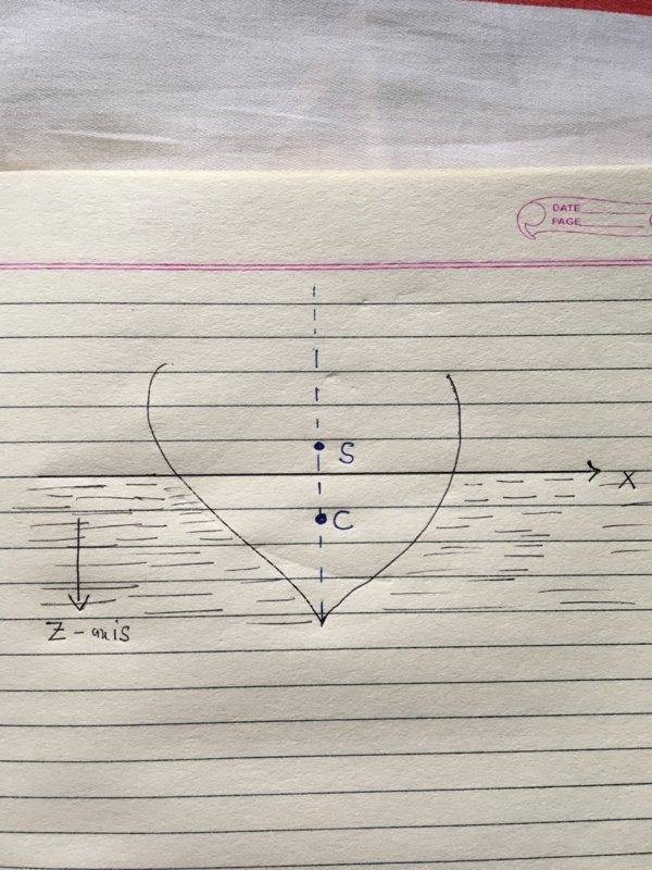

Let’s say we have a boat whose longitudinal axis is the y-axis (which goes into the screen in the figure below) standing upright in a still water .
##S## is the Center of Mass of the boat and ##C## is the Center of Mass of the displaced water.On ##S## lies the force ##\mathbf W## (the weight of the boat) and on ##C## acts the buoyant force and they exactly cancel each other (Archimedes’ Principle). Hence, the boat remains in the equilibrium.
It is a proven fact that the buoyant force acts on the Center of Mass of displaced water.

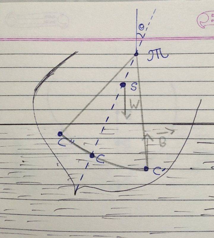

Now, imagine we rotate our boat (y-axis as the axis of rotation) towards right by some infinitesimal angle ##\theta## (with vertical), the new Center of Mass of displaced water is ##C’##. Rotate the boat (from equilibrium position) towards left by the same infinitesimal angle, the new Center of Mass of displaced water is ##C”##. Let ##\mathscr{M}## denote the Center of curvature of the curve ## C”~ C ~ C’##, let’s call it metacenter.
(I would like to apologise for my strange looking ##\mathscr{M}## and hand made diagrams, due to lockdown I’m away from my home and hence have no access to my Mac)
Since, buoyant force ##\mathbf B## always acts on the current center of mass of displaced water, therefore, in the figure buoyant force acts on ##C’## vertically above. Now, ##\mathbf W## and ##\mathbf B## would acts as couple and hence produce a rotation. As far as I can think, the boat will rotate about ##S## and hence ##\mathbf W## will have no contribution in rotation of our boat, it’s our buoyant force ##\mathbf B## which would produce an anti-clockwise rotation (the vector ##\vec{r}## from ##S## to the line of action of ##\mathbf B##, and hence by right hand rule a torque will be produced which points into the paper).
Now, my doubt is that it is written that if metacenter ##\mathscr{M}## were to lie below ##S## then the net moment produced would tend to increase the disturbance (that is it would tend to increase the angle with respect to the vertical, that is it would cause a rotation to the right) and I cannot understand how and why.
How can ##\mathscr{M}## ever affect the direction of rotation? I want to why did we designated a letter to the Center of curvature of curve ##C”~C~C’##, what’s the significance of ##\mathscr{M}##?
The problem with your analysis, is that you rotate the boat around the center of mass. The hull of the ship as a whole will move, and that will actually move the center of buoyancy in the opposite direction than where you think it moves.
It's much easier to rotate the ship around M. The center of buoyancy will always be directly under it, and it then only matters where S is.

I tried to make the diagram but didn’t get center of buoyancy towards the elevated side of the boat.

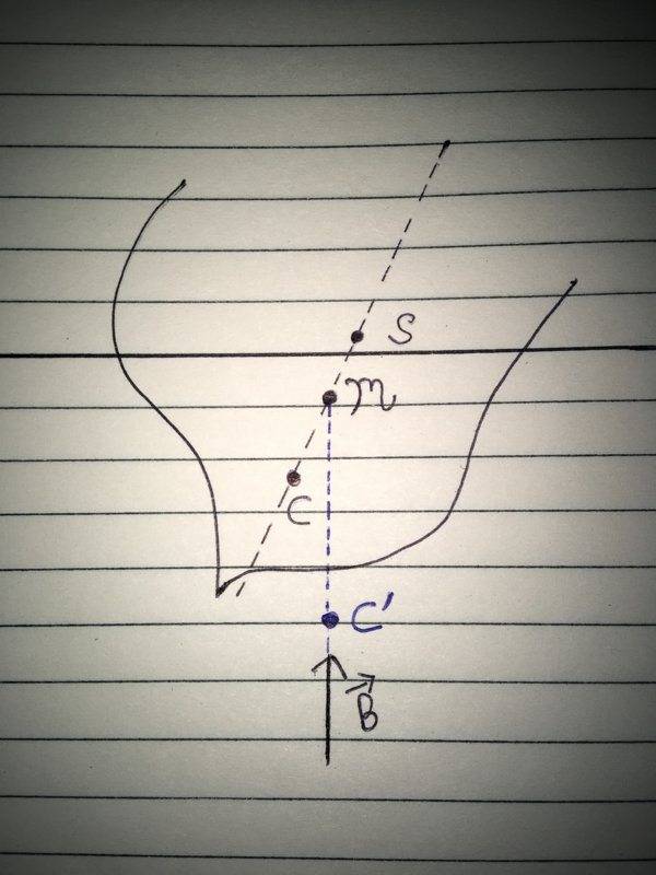

I have made ##\mathscr{M}## below ##S## (the Center of Mass of the boat) and from ##\mathscr{M}## I dropped a vertical, so by the definition of “metacenter” the new center of buoyancy will lie on the vertical line passing through the ##\mathscr{M}## . How would I get center of buoyancy on the elevated side of the boat?
Right, and in which direction will the moment of the buoyant force around the center of mass act then?
I think the buoyant force will act on the Center of Buoyancy, since center of buoyancy lies on the vertical line (that is to the right of ##C##) the moment created by the buoyant force will stabilise the disturbed position instead of increasing it.
Draw the new center of buoyancy, the force of buoyancy and its moment around the center of mass.

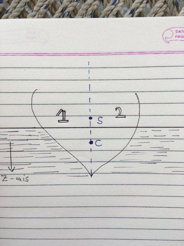

I need to state my problem clearly (although A.T. has solved my actual problem).
Consider this image:
In the image I have divided the boat into two parts, ##1## and ##2##. Ki the situation shown, the weight of the boat at ##S## is balanced by the buoyant force at ##C##.
Now, let’s tilt the boat towards the side. ##2##, that is side ##1## would go up and ##2## will come down.

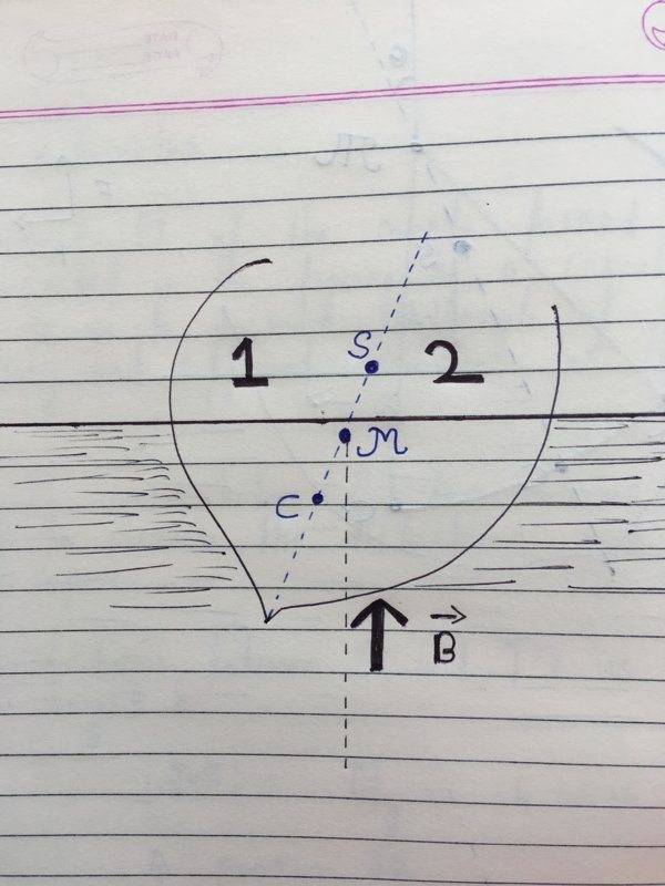

Now, since metacenter lies below ##S## therefore buoyant force will cause a clockwise rotation and consequently side ##2## will go further down.
But from intuition, if the buoyant force were to act on the vertical line passing through ##\mathscr{M}## it would surely act on the surface of our hull on the side ##2## (I have made a big black arrow pointing upwards at bottom of the hull) and should make the side ##2## to rise up and hence an anti-clockwise rotation. Why is there a discrepancy ?
I think I have made some mistake in my diagrams. Help me out through this.
You are conflating rising up and rotating:
- The rising up doesn't happen, because the weight balances the buoyant force.
- As for the rotation: If you push on something upwards, at a point left of its center of mass, then it tilts to the right. How you have labeled that part of the object is irrelevant.
