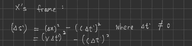

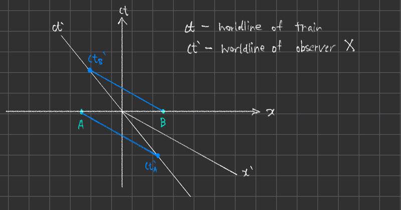

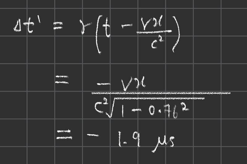

I have two questions. The First one is:
I can obtain the time difference between the events in the observer's reference frame easily from the Lorentz transformation equation. It seems that the negative sign implies the order of events. But I do not get how.
Instead, I can draw a Minkowski diagram to determine the order.
Given that light bulb A was on the left end of the train, I could find that A happened earlier than B.
How can I tell from the sign which event occurred earlier?
The second question is:

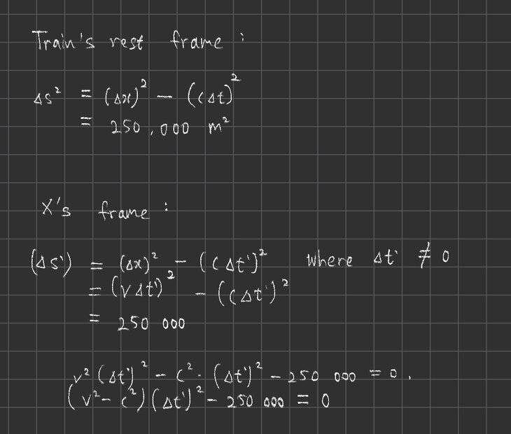

@Orodruin said the spacetime equation method could work by substituting Δx with vΔt, so I tried directly subbing in vΔt for Δx. Here's what I got:
where v = 0.76 c (I forgot to put the the squared sign, but it was included in the calculation)
Using the calculator, I get
Δt' = ± 2.6i μs
To explain this with my shallow knowledge on relativity, it seems that directly substituting v into the equation may break the invariance (sorry for my terrible English). The expressions involving Δt and Δx come from the Lorentz transformations, and they ensure the invariance because they are taking account of the gamma factor.
When I use Δx' - calculated from the Lorentz transformation equation - for the spacetime equation, I get the correct value for Δt' which is 1.9 μs.
Is my interpretation of the error with the substitution method correct? And please let me know if there were any calculation mistakes.
Thank you.
Note that ##\Delta t## is inherently ambiguous unless you specify the order of events. Also, which frame is primed frame in this case? And what is the direction of the velocity? All these variables lead to an answer of ##\pm## something. And, as you can see, it's impossible to figure out which event occurred first without being more explicit about how you've set the problem up.
It seems to me that you need practice at setting up the Lorentz transformation (and inverse transformation). I would prefer to see you do it that way.

With that set up you need the inverse Lorentz transformation to transform to the X frame.
How could you tell that I had to use the inverse Lorentz transformation equation?
I get different signs from the spacetime and Lorentz transformation equation.
If I got a negative sign, does that mean I assigned a wrong sign to my variables?
Thank you.
The velocity of the rod relative to X is ##v##. Hence, the velocity of X relative to the rod is ##-v##. This implies the inverse transformation going to the X frame.
