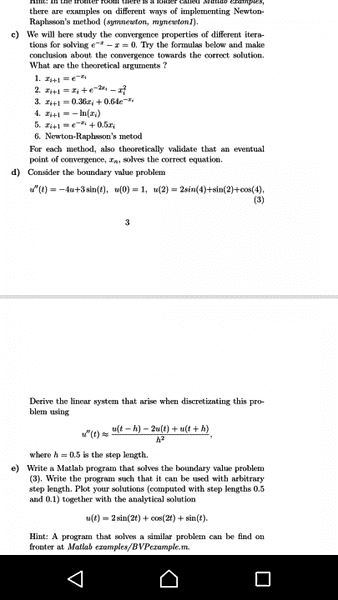

Consider the boundary value problem
\begin{equation}
u''(t)=-4u+3sin(t),u(0)=1,u(2)=2sin(4)+sin(2)+cos(4)
\end{equation}
Derive the linear system that arise when discretizating this problem using
\begin{equation}
u''(t)=\frac{u(t-h)-2u(t)+u(t+h)}{h^2}
\end{equation}
where h=0.5 is the step length.
Evaluate the second derivative at the first boundary
\begin{equation}
u''(0)=-4u(0)=-4
\end{equation}
Now if iterating with step length h=0.5 we should have
for t=1:100
\begin{equation}
\begin{cases}
u''(t)=-4u(t)+3sin(t)\\
u(t+1)=u(t)+h^2u''(t)
\end{cases}
\end{equation}
end
When I do this iteration in I don't end up at u(2)=2sin(4)+sin(2)+cos(4) which make me conclude that I am doing something wrong. Can somebody please explain how I should use Equation (2) to calculate the next value?

I don't know where your second equation above comes from. Let's assume for the moment that it is correct. The main problem I see is that your step of h = 0.5 is way too large. Your interval is [0, 2]. If you divide that into 100 subintervals, each is of length .02. Possibly h is half of that, or h = .01.
Linder88 said:
When I do this iteration in I don't end up at u(2)=2sin(4)+sin(2)+cos(4) which make me conclude that I am doing something wrong. Can somebody please explain how I should use Equation (45) to calculate the next value?
When t = 100, you are calculating u(101), not u(2).
Also, do you mean equation 10 rather than equation 45? That equation is only an approximation, with closer values for smaller values of h.

Well, the original question looks like in the attached picture. Let me know if it doesn't work or if you can't see it. I am excited to hear your comments on the questions.

I believe that the first part ("Derive the linear system that arise when discretizating this problem using... h = 0.5") is
##u''(.5) = \frac{u(0) - 2u(.5) + u(1)}{(.5)^2}##
##u''(1) = \frac{u(.5) - 2u(1) + u(1.5)}{(.5)^2}##
##u''(1.5) = \frac{u(1) - 2u(1.5) + u(2)}{(.5)^2}##
I could be wrong, but I think this is what they're looking for.
For the other part, take a look at the Matlab code that is mentioned in the problem statement in your book.

Thank you, this at least gives me something to write in the report :)

No: you do not have ##u(t+1)=u(t)+h^2u''(t)##; if anything, you should have ##u(t+h) \approx u(t) + h u'(t) + \frac{1}{2} h^2 u''(t)##. However, when you make the finite-difference approximation to ##u''(t)## and substitute that into the DE, you will get an equation linking ##u(t-h), u(t)## and ##u(t+h)##, so if you know ##u(0)## and ##u(h)## you can get ##u(2h)##, then ##u(3h)##, etc. However, this is a so-called two-point boundary value problem (because your boundary conditions are given at two separate point ##t = 0## and ##t = 2##), so your condition at ##t = 0## is not enough, by itself. You do know ##u(0)##, so if you assume a value ##u(h)= c## as an unknown problem parameter, you will be able to carry out all the iterations in terms of a symbolic ##c##, until you reach ##t = 2##. At that point you will have ##u(2)## expressed as a linear function of the parameter ##c##, so you get an equation that determines ##c##.
