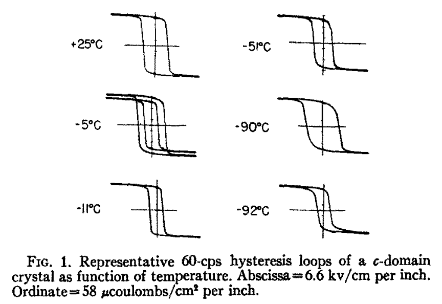

After reading the original 1930 paper by Sawyer and Tower (link to original paper here), I noticed that their hysteresis loops are mirrored around the y-axis from many of the ferroelectric hysteresis loops reported today ( see FE examples here, here, here). Why? Has something changed in the measurement approach, or does the differing orientation imply something about the sample under test? (Sawyer and Tower were characterizing Rochelle Salt.)
Here are example hysteresis loops from Sawyer & Tower:

The figures are not better in the scanned PR paper, but isn't this simply a question of how you "pole" the voltages measured by the osci?
vanhees71 said:
(...) (I)sn't this simply a question of how you "pole" the voltages measured by the osci?
I sincerely hope so, since that would be very easy for me to understand. :smile: The equation used to represent these measurements is [tex]J = A\frac{dP}{dt} + C\frac{dV}{dt} + \frac{V}{R}[/tex] where J is the measured current, A is the area of the capacitor, C is the capacitance, V the applied voltage, R the intrinsic sample resistance (R is not constant, but a function of voltage), and P is the sample polarization. Given this relationship, how it would be possible to apply a negative voltage but measure a positive charge displacement/polarization?
Here is another mirrored hysteresis loop published by Wieder in 1955 - "Ferroelectric Hysteresis in Barium Titanate Single Crystals":
