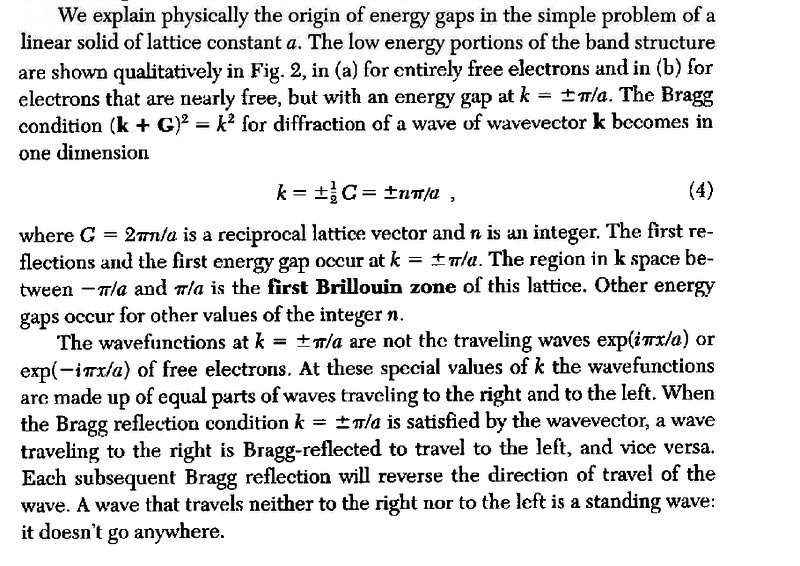

My book has a discussion of how the Bragg model can explain the origin of energy band gaps in solid. I have attached the relevant part of this discussion. I would very much like if someone could help me understand what it's basically trying to say.
Facts:
1) In the free electron model, the eigenstates of the hamiltonian are plane waves.
2) In the nearly free electron model we consider the free electron waves to be perturbed by a periodic potential.
But what does all this have to do with Bragg reflection? that is:
1) What are the electron waves scattering against?
2) I can see the Brillioun zone boundaries fulfill the Bragg condition so what happens to the electron waves physically at these points? And what happens for the electron waves not fulfilling the Bragg condition?
3) What does the book mean by the fact that the electron waves are standing waves at the zone boundary but not in general? How can a wave be standing at one point and moving at another?
The walls of the periodic potential.
Since there is a reflected and an incoming wave you can get a standing wave behavior that does not extend through all space.
For the Bragg condition - consider what it is a condition on...

It is a condition of the wavevector. But what happens for the wavevectors that do no fulfill the Bragg condition? Shouldn't they exhibit destructive interference? After all the bragg condition is a condition for constructive interference, and the exact opposite can happen too.
A condition of the wave-vector so that the wave does what?
If the wave vector satisfies the Bragg condition - what is special about it?
a condition on the wavevector such that the reflected waves from succesive planes are reflected in phase. If the idea is that the electron waves scatter off the potential barriers surely there are wavevectors for which the reflected waves are out of phase too? - i.e. are extinguished.

But why is it physically that the energy vs k-vector relation is only altered for the k-vectors fulfilling the Bragg conditions. If we accept the fact that the physics behind this is all constructive and destructive interference something should happen for all k-vectors.
When the waves have interfered destructively - what happens to them?
they extinguish each other. Shouldn't that have some effect on the energy-kvector relation? What is it exactly that leads us from constructive interference to the formation of energygaps? I don't understand the physics behind all of this completely.
Let's try something different: Assume that the crystal potential V(x) is very small. Then you can try to calculate it's effect in perturbation theory.
If you start from ##\psi_0=N\exp(ikr)=|k>## and ##E_k=k^2/2m##. Now ##V_{kk'}<k'|V|k>## will only be different from zero if k'=k-K where K is some reciprocal lattice vector.
Now, if ##|\Delta E_{kk'}|=|E_{k'}-E_k|>>V_{kk'}##, the perturbation is unimportant. But if ##|E_{k'}-E_k|\approx V_{kk'}##, we have to use degenerate perturbation theory in lowest order and obtain the perturbed energies ##E_k1## and ##E_{k2}## as solutions of the two by two Schroedinger equation ##H\psi=E-(E_k+E_k')/2)\psi ## with H being the two by two matrix ##\Delta E \sigma_z+V_{kk'} \sigma_x## where ##\sigma_{x,z}## are Pauli matrices.
You will find that the splitting ##2V_{kk'}## when k' fulfills ##|k'|=|k|##, i.e. if scattering is elastic. You can derive from this condition the Laue and Bragg conditions.
Try to plot this explicitly for the one-dimensional case where ##K=2\pi n/a##. Try also to find the explicit form for the two eigenfunctions when the Laue condition is fulfilled.

As I tried to explain, what singles out the zone boundaries is that there constructive interference can happen between states which are energetically degenerate in zeroth order but at other points only between states with different energy.
