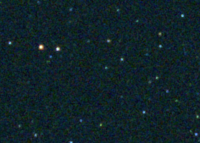

I wonder what's causing my focusing issue... if I focus on a pigeon's eyeball in daylight I can distinguish edges that appear 5 or 6 pixels wide but then at my last astrophotography shoot I had stars that were 26 pixels wide... I used a bahtinov mask to focus, but maybe I was just bad at it or maybe the mirror slap is causing some persistent shake even though I use a 3 second shutter delay after mirror flip up? maybe the whole thing is wobbling since I'm putting 40 lbs on a mount only designed to hold 10-12lbs with no star tracking? maybe temperature change of the front lens after I get focused but before I get on target which can take up to an hour since I have to do plate solving through my cell phone with poor reception? maybe it's the atmosphere since the star wasn't all that high above the horizon at the time?

  • #1,713
Devin-M said:
is that a green star in the top right?
Possibly? I'm color blind... can't say for sure.

No, I edited away the yellow color heavily in Lightroom, which probably messed up the star colors too. :smile:
There are also some weird sky transitions in the photo; I'm not very experienced with Sequator yet (particularly not when mixing stacking stars together with a fixed foreground).
Detections by astrometry.net:
And last, this was the best shot I got of the Milky Way at that time:
Photo info:
Lens: I don't remember, ISO 800, Exposure: 1/8s (1/8s total integration).
(Camera used for all photos: Sony A6000)
