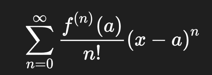

All the information that I have is these are two opposite sign charge infinite plane with some distance d. I also throw this question to my professor, he suggests me to prove it with Taylor series.
But I does not know what variable to setup this with, if anyone have any idea, can you please write down the full process that I can look it through? Thx
