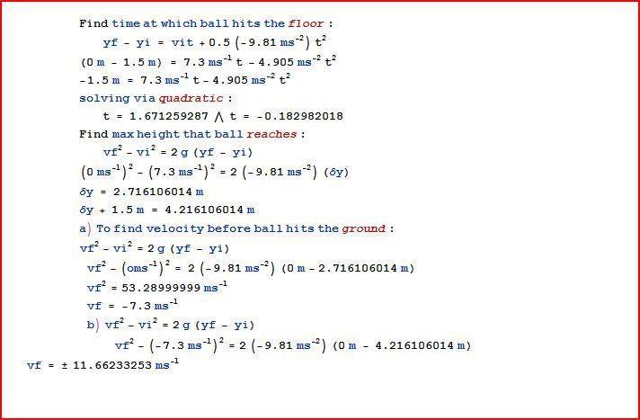

You toss a ball straight up at 7.3ms^-1; it leaves your hand at 1.5m above the floor.
a) Find its velocity before it hits the floor
b) Suppose ball is tossed straight down at 7.3ms^-1, what is the final velocity just before it hits the floor.
c) When would the second ball hit the floor.

Vf^2 - vi^2 =delta y
I know man, been trying to get a head start or next semester's unit during this summer break. Just finished foundation year in uni.
There's a total of 86 questions. I've finished 83 question. Will move on to the next topic when done.
EDIT: Same because vi are both the same weather the ball is thrown straight up from ground of if the ball is tossed at the same speed as if it were thrown straight up from ground.

I just edited a few seconds before your new post.
vi in both circumstances are both the same whether ball is thrown up at 7ms^-1 or thrown down at 7ms^-1.
My mathematical workings reveals the above is true: vf = 9.09ms^-1
Yes and I did allowed g to be negative.
vf^2 - vi^2 = 2(-g)(delta y)
I think I see where the confusion came from. I've always been using negative g but in the event where a numerical g is not required, I would write-suppose any kinematics equation with a g variable as vf^2 - vi^2 = 2(g)(delta y) where the g would, if a numerical value is required, the appropriate sign would be input. So where a numerical value of g is not required, it would appear as thought I took g to be positive.
Also, do you mind explaining the concept and derivation behind sqrt 2d/g?

I would really appreciate if you could shed some light on this:
In part (a): vi = 7.3ms^-1 while delta y = -1.5m
Why is delta y= -1.5m? Is there a rational for not measuring the displacement from ground to max height as opposed to max height to ground?

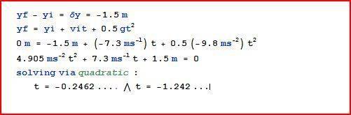

part (c) When would the second ball hit the floor:
Why am I getting a negative t?
The displacement has to be negative because yf < yi and indeed true when yf = 0m and yi = -1.5m above ground as the ball is falling towards the ground and we denote downwards as negative
Recheck your convention. Initial y (at hand level) = 0. Final y (at ground) = -1.5m. Alternatively, you could assign the ground to be zero, and the hand to be +1.5m, in which case, the displacement (final minus initial) is still -1.5m. What you wrote is self-contradictory, because you stated yf < yi, but 0 is greater than -1.5m.
You can do this much more simply without the quadratic using the result from part b).

What I meant was in part (a), we took vi = 7.3ms^-1 because we denote upwards to be positive. In this frame, wouldn't yi = 1.5m and yf = max height achieved by ball? Why is yf - yi then negative?
In short, why are we measuring only the distance traveled by the ball as it falls back to the ground?
Yes you're right. It became much clearer if I visualized a y-coordinate as a reference.
I know: vf = vi+at? I prefer the quadratic though. It gives me a global picture as to what is occurring.
Why should the max height even enter into consideration? You're not asked to work it out.
As I said before, there is *no need* to bother about this. All you need in a kinematics problem is to consider the initial displacement (hand, in this case) and the final displacement (ground, in this case). The ball can do *anything* in the middle (subject to the constraints of a constant acceleration, otherwise the equations don't apply). But you don't have to worry about it.
If you're asked to calculate the max height, THEN you have to worry about it, and you do that by setting the final velocity to zero (because the ball momentarily comes to rest at max height). Then you use the equation relating initial vel, final vel, acceleration and displacement.
EDIT: I see where you might be confused. You might want to review your notes very carefully about the difference between a "distance" and a "displacement". They're related, but quite different, really. Displacement is all that matters in the kinematic equations. But if you want to calculate total distance traveled by the ball as it goes up then goes down to hit the ground, you definitely need to divide the trajectory into two parts and calculate each displacement separately, then add the absolute values.
I worded it quite poorly in haste.
Given the equation vf^2 - vi^2 = 2(-g)(yf-yi):
Using the equation above, am I right to imply that the inputs must be variables occurring within a "specific frame" such as either all variables involved as the ball goes upwards or downwards but never an admixture of variables from 2 occurring frames.
As the ball is tossed, vi = +, g = - and yf >yi but it seems that delta y = - and this is true iff
yf < yi.
From this, and using backwards induction, I deduced that we are interested in the displacement as the ball falls towards the ground.
Therefore, I'm saying isn't it strange that if vi is + upwards then in this occurring frame yf must be a particular positive max height (not that we are interested in max height but I'm expounding on a point)? But it appears as though we split and "mixed" the event of the ball going up and down.
I was under the assumption that if vi = + up, then any unknown in that equation would only tells us everything about what is happening as the ball goes up.
Edit: I did not saw your edit as I was already replying in response to your quote.
yf < yi.
What you wrote is confusing. Basically, the take home message is this: it's all one "frame" (or convention) as long as there is a constant acceleration throughout. Just choose a convenient convention and stick to it! It doesn't matter which way the body is moving or whether it changes direction halfway. All the equations apply throughout.
Sometimes, after solving, you may get more than one answer (usually a maximum of two, since we're dealing with quadratics, at most). Often one answer is physically impossible (like a negative time). But sometimes, both answers are physically plausible. That's when you have to decide, based on your understanding of the physical situation, which answer is the correct one.
I'll contemplate about it. Once I understand fully the convention, I should be able to move on to vectors.
