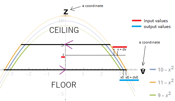

Theorem:
A gas column in thermodynamic equilibrium in a classical homogeneous gravitational field has the same temperature everywhere.
Proof using the laws of motion:
Let at time 0 a point particle with mass ##m## is located at height 0 and its velocity is ##\mathbf{v}_0 = (v_{\text x 0}, v_{\text y 0}, v_{\text z 0})##. Its total energy is
$$ E = \tfrac{1}{2} m (v_{\text x 0}^2 + v_{\text y 0}^2 + v_{\text z 0}^2). $$
Let us assume the particle moves without collisions. At time ##t## it is at height ##z##, its velocity is ##\mathbf{v} = (v_{\text x 0}, v_{\text y 0}, v_{\text z})## and it has the same total energy
$$ E = \tfrac{1}{2} m (v_{\text x 0}^2 + v_{\text y 0}^2 + v_{\text z}^2) + mgz,
$$ where ##g## is the gravitational acceleration.
Comparison of the two equations yields
v_{\text z 0}^2 = v_{\text z}^2 + 2gz, \tag 1
v_{\text z 0} = \pm \sqrt{v_{\text z}^2 + 2gz}. \tag 2
Differentiation of equation ##(1)## yields
$$ v_{\text z 0} dv_{\text z 0} = v_{\text z} dv_{\text z}. \tag 3 $$
Let ##\rho(z, v_\text z)## is the density of particles at height ##z## with vertical velocity ##v_\text z##.
Consider at time 0 a bunch of particles at height 0 with velocities in range from ##v_{\text z 0}## to ##(v_{\text z 0} + dv_{\text z 0})##; they contribute to ##\rho(0, v_{\text z 0})##. The number of such particles, which cross a unit-area horizontal boundary at this height in unit time, is
$$ dN = \rho(0, v_{\text z 0}) v_{\text z 0} dv_{\text z 0}. \tag 4$$
At time ##t##, the same particles are at height ##z##, their velocities range from ##v_{\text z}## to ##(v_{\text z} + dv_{\text z})## and they contribute to ##\rho(z, v_{\text z})##. The same number of particles will cross a unit-area horizontal boundary at this height.
$$ dN = \rho(z, v_{\text z}) v_{\text z} dv_{\text z}. \tag 5$$
Equations ##(2)##, ##(3)##, ##(4)##, ##(5)## together yield
$$ \rho(z, v_{\text z}) = \rho\left(0, \pm \sqrt{v_{\text z}^2 + 2gz}\right). \tag 6$$
Let the velocity distribution at height 0 is Maxwell–Boltzmann (i.e. thermal) with temperature ##T##. That means the density at that height is
$$ \rho(0, v_{\text z}) = C \exp\left(-\frac{m}{k_\text B T} \cdot \frac{v_{\text z}^2}{2} \right), \tag 7
$$ where ##C## is a constant.
From equations ##(6)## and ##(7)## we get
$$ \begin{align}
\rho(z, v_{\text z}) \nonumber
& = C \exp\left(-\frac{m}{k_\text B T} \cdot \frac{v_{\text z}^2 + 2gz}{2} \right) \nonumber \\
& = \exp\left(-\frac{m}{k_\text B T} \cdot gz \right) \cdot C \exp\left(-\frac{m}{k_\text B T} \cdot \frac{v_{\text z}^2}{2} \right) \nonumber \\
& = \exp\left(-\frac{m}{k_\text B T} \cdot gz \right) \cdot \rho(0, v_{\text z}). \nonumber
\end{align} $$
We can see that the velocity distribution is the same at all heights ##z## (i.e. the temperature is the same everywhere) and the density decreases exponentially with height ##z##. Interaction between the particles cannot change this distribution, because they are already in equilibrium.
End of proof.

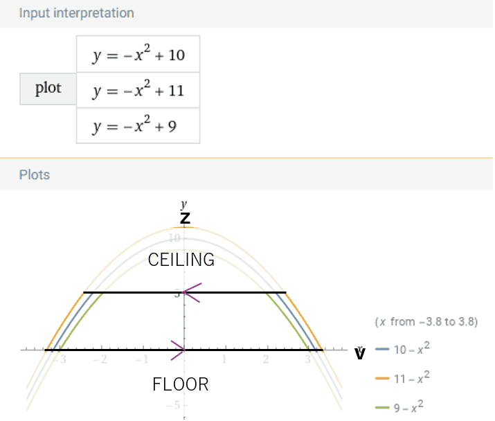

By differentiation of (1) I got (3)Petr Matas said:Differentiation of equation (1) yields
(3)vz0dvz0=vzdvz.
Let ρ(z,vz) is the density of particles at height z with vertical velocity vz.
[tex]v_{\text z 0} dv_{\text z 0} = v_{\text z} dv_{\text z}+gdz. \tag 3[/tex]
Am I wrong ?
Petr Matas
- 91
- 16
At height 0, let us have a narrow velocity interval from ##v_{\text z 0}## to ##(v_{\text z 0} + dv_{\text z 0})##. The goal is to find what velocity interval at height ##z## it is mapped to. Therefore ##z## is a constant. Any ideas how to express it more clearly?anuttarasammyak said:By differentiation of (1) I got (3)
Am I wrong ?
Homework Helper
- 3,207
- 1,617
Thanks. So have you conquered your losing-speed intuition by your calculation which tells same velocity distribution but different number density by height ?
Petr Matas
- 91
- 16
Exactly.anuttarasammyak said:Thanks. So have you conquered your losing-speed intuition by your calculation which tells same velocity distribution but different number density by height ?
Homework Helper
- 3,207
- 1,617
Congratulations. Let me understand more. Say a bouncing ball goes up and down between floor and ceiling. By gravity
ball speed near floor > ball speed near ceiling
time duration ball staying in 10cm layer from floor < time duration ball staying in 10cm layer from ceiling
ball number desity in 10cm layer from floor < ball number density in 10cm layer from ceiling
This contradicts the result. Where am I wrong ?
