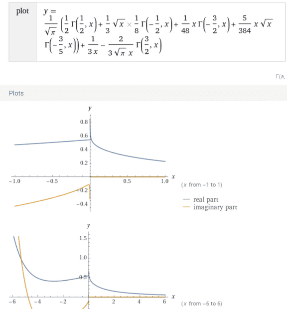

Based on this idea, I would like to estimate average height <z> of particles.
The trajectory
[tex]z=v_0t-\frac{1}{2}gt^2[/tex]
1. lower energy particle which does not touch the ceiling at height h.
maximum height
[tex]\frac{v_0^2}{2g}<h[/tex]
time to reach maximum
[tex]T=\frac{v_0}{g}[/tex]
[tex]<z>=\frac{1}{T}\int_0^T z(t) dt[/tex]
[tex]=\frac{v_0^2}{3g}[/tex]
2. higher energy particle which touches the ceiling
[tex]\frac{v_0^2}{2g}>h[/tex]
time to reach the ceiling
[tex]T=\frac{v_0-\sqrt{v_0^2-2gh}}{g}[/tex]
[tex]=\frac{(v_0-\sqrt{v_0^2-2gh})(2v_0+\sqrt{v_0^2-2gh})}{6g}[/tex]
[tex]=\frac{v_0^2+2gh-v_0\sqrt{v_0^2-2gh}}{6g}[/tex]
I do not keep enough energy to carry out ensemble integral with weight of Maxwell way Gaussian spectrum for ##v_0## to know whether it coincides with the result of statistical mechanics for thermal equillibrium state of
[tex]<z>=-h\frac{\partial}{\partial (\beta mgh)}\log{\frac{1-e^{-\beta mgh}}{\beta mgh}}[/tex]
or not. If you are tough enough, I should appreciate your effort.
maximum height
v022g<h
T=v0g
<z>=1T∫0Tz(t)dt
=v023g
Integration with weight
[tex]f(v_0)=\sqrt{\frac{m\beta}{2\pi}}e^{-\frac{m\beta}{2}v_0^2}[/tex]
is rather easier. Contribution of the balls which do not reach the ceiling to <z> is
[tex]2 \int_0^\sqrt{2gh} dv_0 \frac{v_0^2}{3g} \sqrt{\frac{m\beta}{2\pi}}e^{-\frac{m\beta}{2}v_0^2}[/tex]
[tex]=\frac{2}{3\sqrt{\pi}}\frac{1}{m\beta g}\int_0^{m\beta gh}\sqrt{t}e^{-t} dt[/tex]
[tex]=h\frac{2}{3\sqrt{\pi}}\frac{1}{m\beta gh} (\frac{\sqrt{\pi}}{2}-\Gamma(\frac{3}{2},m\beta gh))[/tex]
ref. https://www.wolframalpha.com/input?i=2/(3sqrt(pi))(integration+of+√xe^(-x)+from+0+to++x)divided+by+x
I observe in both high and low tenperature limit, the contribution tends to zero. It has a peak of about 0.15 h around ##mg\beta h=1##.
v022g>h
T=v0−v02−2ghg
<z>=1T∫0Tz(t)dt
=(v0−v02−2gh)(2v0+v02−2gh)6g
=v02+2gh−v0v02−2gh6g
[tex]=\frac{h}{3a}(1+a-\sqrt{1-a})[/tex]
[tex]=h(\frac{1}{2}+\frac{1}{3}\sum_{n=2}^\infty \binom{\frac{1}{2}}{n}(-)^n a^{n-1})[/tex]
[tex]=h(\frac{1}{2}+\frac{a}{24}+\frac{a^2}{48}+\frac{5a^3}{384}+...)[/tex]
where
[tex]a=\frac{2gh}{v_0^2}<1[/tex]
To investing the contribution according to a^n terms, integration of a^n with weight
for region a<1 is
[tex]\sqrt{\frac{m\beta gh}{\pi}}\int_0^1 a^{n-\frac{3}{2}} e^{\frac{-m\beta gh}{a}}da[/tex]
[tex]=\sqrt{\frac{(m\beta gh)^n}{\pi}}\int_0^\frac{1}{m\beta gh} t^{n-\frac{3}{2}} e^{-\frac{1}{t}}dt[/tex]
[tex]=\sqrt{\frac{(m\beta gh)^n}{\pi}}\Gamma(\frac{1}{2}-n, m\beta gh)[/tex]
https://www.wolframalpha.com/input?i=integrate+x^(n-3/2)+e^(-1/x)+from+0+to+x
Thus contribution to <z> from balls touching the ceiling is
[tex]\frac{h}{\sqrt{\pi}}[\frac{1}{2}\Gamma(\frac{1}{2},b)+\frac{1}{3}\sum_{n=2}^\infty \binom{\frac{1}{2}}{n} (-)^n b^{\frac{n-1}{2}}\Gamma(\frac{3}{2}-n,b)][/tex]
where
[tex]b=mgh\beta[/tex]
The contribution to <z> by the lowest four power term is shown in https://www.wolframalpha.com/input?i=plot+y=1/(sqrt(pi))(1/2+Gamma(1/2,x)+1/3+sqrt{x}+1/8+\Gamma(-1/2,x)+1/48+x+Gamma(-3/2,x)+5/384+x+sqrt(x)+Gamma(-3/5,x)))
In combination of 1 and 2 we get <z>/h plot wrt ##mgh\beta## which is in the aproximation above said as shown in https://www.wolframalpha.com/input?...,2]]Gamma\(40)Divide[3,2]-n+2\(44)x\(41)\(41)
Due to restriction of computing resource I could get n=0,1,2,3 but not value for higher orders.
I do not keep enough energy to carry out ensemble integral with weight of Maxwell way Gaussian spectrum for v0 to know whether it coincides with the result of statistical mechanics for thermal equillibrium state of
<z>=−h∂∂(βmgh)log⁡1−e−βmghβmgh
or not.
Plot of <z>/h in thermal equillibrium is https://www.wolframalpha.com/input?i=differentiate+-+log+(1-e^(-x))+++log+x
Comparing it with the bouncing-ball-system, I observe the difference, damping is slower in thermal equillibrium.
I should apreciate it if you would check and confirm/claim my calculation.

Petr Matas said:
We have already derived the density
$$ \rho(z) \propto \int_{-\infty}^{+\infty} \rho(z, v_{\rm z}) \, dv_{\rm z} \propto \exp(-\beta m g z)
$$ using the laws of motion, so we can start from there.
Let us have a vertical column of ideal gas.
##\rho(z)## is the density of particles at altitude ##z##,
##\beta = \frac {1} {k_{\rm B} T}## is the thermodynamic beta,
##k_{\rm B}## is the Boltzmann constant,
##T## is the thermodynamic temperature,
##m## is the particle mass,
##h## is the column height,
##g## is the gravitational acceleration.
The average altitude of particles above the column floor (i.e. the altitude of the column's center of mass) can be written as
\begin{align}
\left< z \right> &= \frac {\int_0^h z \, \rho(z) \, dz} {\int_0^h \rho(z) \, dz} \nonumber \\
\nonumber \\
&= \frac {\int_0^h z \, e^{-\beta m g z} \, dz} {\int_0^h e^{-\beta m g z} \, dz} \nonumber \\
\nonumber \\
&= \frac {1} {β m g} - \frac {h} {e^{β m g h} - 1} \nonumber
\end{align}
$$ (calculation).
Some interesting values:
\begin{align}
& \lim_{h \to \infty} \left< z \right> = \frac {1} {β m g} \nonumber \\
\nonumber \\
& \lim_{T \to 0} \left< z \right> = 0 \nonumber \\
\nonumber \\
& \lim_{T \to \infty} \left< z \right> = \frac{h}{2} \nonumber
\end{align}
Please find https://www.wolframalpha.com/input?i2d=true&i=Divide[2,3Sqrt[pi]]Divide[1,x]\(40)Divide[Sqrt[pi],2]-Gamma\(40)Divide[3,2]\(44)x\(41)\(41)+Divide[1,Sqrt[pi]]\(40)Divide[1,2]+Gamma\(40)Divide[1,2]\(44)x\(41)+Divide[1,3]Sum[Power[\(40)-1\(41),n],{n,0,100}]Divide[\(40)Divide[1,2]\(41)!,\(40)Divide[1,2]-n-2\(41)!\(40)n+2\(41)!]Power[x,Divide[\(40)n+1\(41),2]]Gamma\(40)Divide[3,2]-n+2\(44)x\(41)\(41)-Divide[x+1-Power[e,x],x-x*Power[e,x]] wolfram calculation of height averages,
<z>/h of independent bouncing balls - <z>/h of thermal equillibrium ##\leq## 0
where parameter x is ##mgh\beta##. They coincide with 1/2 at x=0 but do not coincide for x>0. I do not expect that higher order n terms which I cannot calculate due to compuring resource limit, would contribute so that they coincide.
