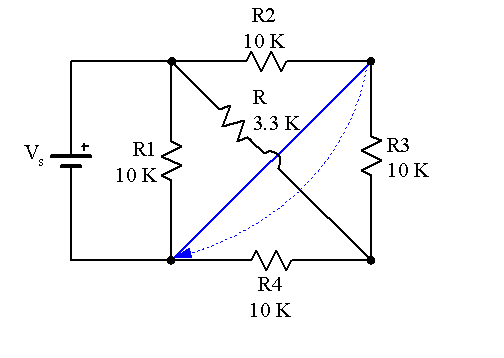

Hi eatlsep, Welcome to Physics Forums.
Combining the rightmost 10K with the bottom 10K is fine, but note that the top 10K is NOT in parallel with the diagonal R.
The diagonal going from bottom left to top right is a straight wire, so those two nodes at either end of it are really just one node. That means you are free to shorten that diagonal wire as much as you like. So imagine that this wire is shortening, dragging the two top-right corner resistor connections with it until the wire vanishes and the resistors are now connected at the bottom left corner of the square. What parallelism can you take advantage of now?
Thank you for the response. I'm sorry, I am a little confused what you mean by dragging the top tow resistors as the wire shortens
Like this:
Circuit schematic with a voltage source Vs and resistors R1 10 K, R2 10 K, R3 10 K, R4 10 K and R 3.3 K in a bridge arrangement, with a blue arrow drawn across the diagonal.
Pull the connections of R2 and R3 down to the other end of the blue wire.
  • Circuit schematic with source Vg, resistors R1 10 K, R2 10 K, R3 10 K, R4 10 K and R 3.3 K in a bridge arrangement, with a blue arrow drawn across the diagonal.

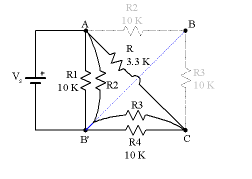

So R1 and R2 are in parallel. R3 and R4 are in parallel. Does it matter where I put the combined resistors?. For example, I combine R1 and R2 and put the combined resistor at R1. Then I combine R3 and R4 and put the combined resistor at R3 so that now R1eq and R are in parallel. Can I do this?
No, R1 and R were not in parallel before, so they can't be now. That goes for R1eq as well. Remember, no physical change is made to the circuit by moving connections along existing continuous wires.

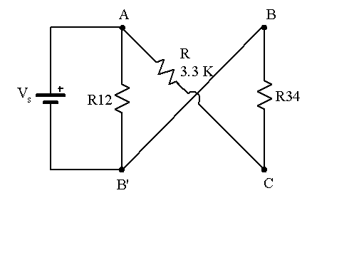

If you place the combined resistance R34 = R3||R4 where R3 was originally drawn, then you still have to maintain its connections to the rest of the circuit, no doubt by bending or extending wires. Something like this:
Circuit schematic: voltage source Vs on the left feeds nodes A and B', with resistor R12 between them; resistor R 3.3 K runs from A diagonally across to C; resistor R34 is between B and C on the right, with B' connected to B.
Combine what's in parallel, then combine what's in series,... rinse, repeat :smile:
Probably easier just to place R34 where R4 was...
Circuit schematic with a voltage source Vs on the left and nodes A, B, B' and C; resistors R1 10 K, R2 10 K, R 3.3 K, R3 10 K and R4 10 K, with R2 and R3 greyed out.
  • Circuit schematic with voltage source Vs on the left, nodes A and B' connected across resistor R12, resistor R of 3.3 K crossing between A and C, and resistor R34 between B and C, with B' and B also linked by a diagonal wire.
  • Circuit schematic with battery Vs on the left feeding nodes A (top) and B' (bottom); R1 10 K and R2 between A and B', R 3.3 K from A to a junction, R3 and R4 10 K on the bottom right, with nodes B and C labelled and a dashed blue line from B' to B.

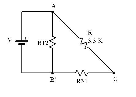

No, R12 and R34 are not in series; there's something else connected where they join (it's the bottom of Vs). For two components to be in series, where they connect must be to each other and to nothing else. That is, they must exclusively share a node.
However, R is in series with one of the newly combined pairs. Can you spot it?

Not as originally drawn. But after combining R2 and R4 into R34, then R and R34 are in series by the definition.
Circuit schematic with a voltage source Vs on the left feeding nodes A, B' and C; resistor R12 runs between A and B', resistor R (3.3 K) runs from A to C, and resistor R34 runs from B' to C.
  • Circuit schematic with a voltage source Vs on the left feeding nodes A, B' and C; resistor R12 runs between A and B', resistor R3.3 K runs from A to C, and resistor R34 runs from B' to C.
