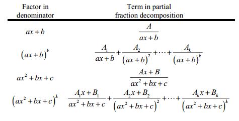

What's the best approach to solving the partial-fraction decomposition of the following expression?
$$\frac{1}{(a-y)(b-y)}$$
The expression is not of the following forms:
Table of partial fraction forms: factor ax+b gives A/(ax+b); (ax+b)^k gives A1/(ax+b) + A2/(ax+b)^2 + ... + Ak/(ax+b)^k; ax^2+bx+c gives (Ax+B)/(ax^2+bx+c); (ax^2+bx+c)^k gives sums of (Aix+Bi)/(ax^2+bx+c)^i up to i=k.
But I know the solution is
$$= \frac{1}{(a-b)(y-a)}-\frac{1}{(a-b)(y-b)}$$
  • Table of partial fraction decomposition forms: factor ax+b maps to A/(ax+b); (ax+b)^k maps to A1/(ax+b) + A2/(ax+b)^2 + ... + Ak/(ax+b)^k; ax^2+bx+c maps to (Ax+B)/(ax^2+bx+c); (ax^2+bx+c)^k maps to sum of (A_i x + B_i)/(ax^2+bx+c)^i up to i = k.
  • Table of partial fraction forms: factor ax+b gives A over ax+b; (ax+b)^k gives A1/(ax+b) up to Ak/(ax+b)^k; ax^2+bx+c gives (Ax+B) over ax^2+bx+c; (ax^2+bx+c)^k gives (A1x+B1)/(ax^2+bx+c) up to (Akx+Bk)/(ax^2+bx+c)^k.
I don't use such tables. Any time I want to do a partial fraction decomposition, I just write (e.g.) [itex]\frac{1}{(a-y)(b-y)}=\frac{A}{a-y}+\frac{B}{b-y}[/itex] and then determine A and B.
Anyway, if you multiply the factors you'll see that its in fact in the form of the third entry in the table!
What the table is saying is the for each distinct (i.e., not repeated) factor (ax + b) in the denominator, you'll have a term ##\frac{A}{ax + b}## in the decomposition. So ##\frac{1}{(a - y)(b - y)}## results in ##\frac{A}{a - y} + \frac{B}{b - y}##.
Equate the two expressions and solve for A and B, which is more or less what Shyan said.
