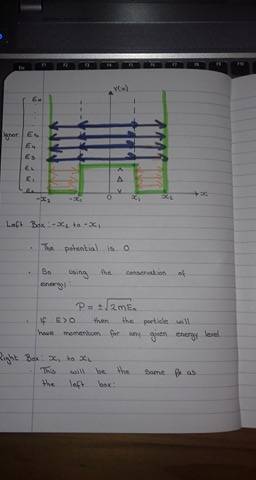

Okay so I have been thinking about this a bit more. I have attched photos of my workings, and tryed to explain best to what I think is going on, I know normally it not great to post photo but I couldn’t draw a decent enough diagram to convey what I was thinking.
Handwritten sketch of a particle in a box potential: a well with energy levels E1 to E6 drawn as horizontal lines, walls at x = -x2, -x1, x1, x2 with V(x) on the vertical axis, and notes on the left box and right box below.

  • Handwritten sketch of a particle in a box potential: a well with energy levels E1 to E6 drawn as horizontal lines, walls at x = -x2, -x1, x1, x2 with V(x) on the vertical axis, and notes on the left box and right box below.

Remember, the equation is p2/2m +V(x) =E
There are walls of infinite high at x1 and x4. There is a barrier between x2 and x3. The function is defined between x1 and x2, outside it is infinite.
x1<x ≤ x2 V(x) = 0
x2 <x ≤ x3 V(x) = Δ
x3 < x ≤ x4 V(x) = 0
If E < Δ the particle can not exist in the interval x2 <x ≤ x3. It is confined "inside" one of the boxes, either between x1 and x2 or between x3 and x4.

If E ≥ Δ the particle can exist in the whole interval x1 <x ≤ x4, only its kinetic energy changes above the barrier. It is not "inside" any boxes

The drawing is right, but I can not read your handwriting.
Sorry, from your pervious comment, and a couple more hours, I realized what was going on. Thank you for the advice.
