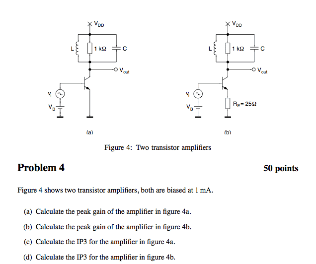

1. Homework Statement
Hi all.
Lets start with subquestion a).
How do i calculate the PEAK gain?
I drew the small signal equivalent and calculated the gain: Av=vo/vi=-gm(ro//R=1kΩ//L//C)
Is that correct? How do i now calculate the peak gain?
Thank you for you help!

David - do you really mean R||L||C ? Which dimension do you expect as a result?
Have you heard already about the term "resonance"?
I mean R||sL||1/sC.
r0 can be neglected.
That would result in jwRL/(R-w^2RCL+jwL).
The peak gain would be at w=1/sqrt(LC)? (Thanks LvW)
After some calculations i get Av=-gmR=-(Ic/Vt)R= -38.4, IAvI=31.7dB
Yes - the result looks OK (for case a).
