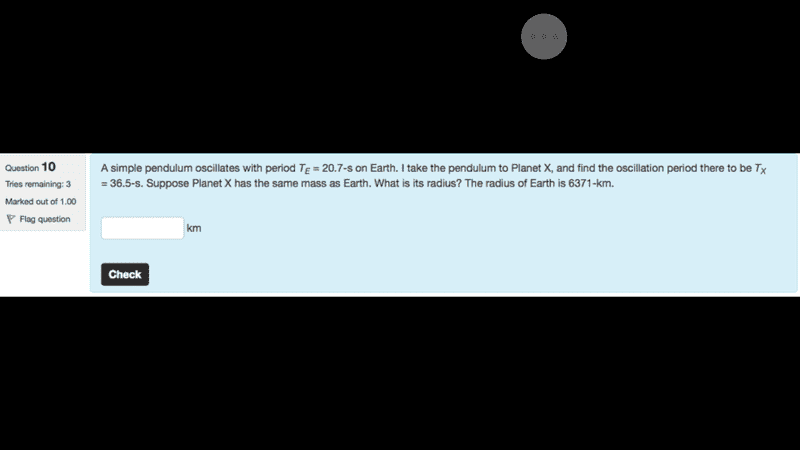

The discussion centers on calculating the period of a pendulum on Earth compared to another planet with a significantly smaller radius. The user initially miscalculated the period due to neglecting to square the radius in their formula. After correcting this error, they arrived at a period corresponding to a radius of 11,200 km. The conversation emphasizes the importance of following structured templates for calculations and deriving formulas symbolically for clarity.

The radius seems very small (a factor of 10 less than Earth's radius. But I can't see any mistake in the solution.
