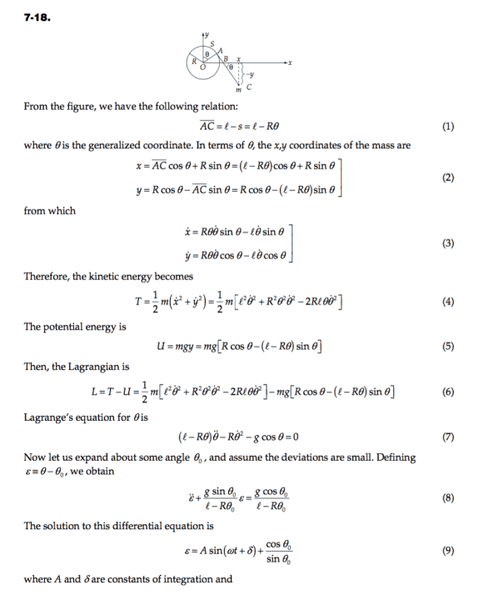

I am studying a question in Marion's classical mechanics:
Diagram of a pendulum: a mass m hangs from a string of length l that wraps over a vertical disk of radius R, with angles theta1 and theta2 marked and the dashed arc of swing shown.
I am successful in obtain the equation of motion, which is
Equation (l − Rθ)θ̈ − Rθ̇² − g cos θ = 0, with θ̈ and θ̇ denoting second and first time derivatives of θ.
where theta is the theta shown in
Diagram of a bead or mass m hanging from a circular track of radius R centred at O, with a cord from point A to m at angle theta from the vertical y-axis, axes x and y marked and the point B and C labelled.
. However, in the second part of the solution,
Typeset derivation: small-angle expansion about theta_0 gives epsilon'' + (g sin theta_0)/(l - R theta_0) epsilon = (g cos theta_0)/(l - R theta_0), equation (8), with solution epsilon = A sin(omega t + delta) + cos theta_0 / sin theta_0, equation (9).
, it puts derivative of theta to be zero and I can't understand this.

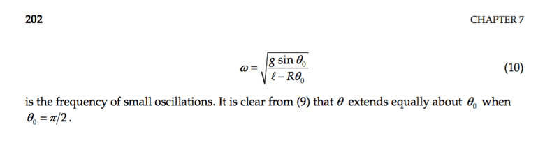

Page from a textbook, chapter 7, page 202, showing equation (10): omega equals the square root of g sin theta-0 over l minus R theta-0, followed by text stating it is the frequency of small oscillations and that theta extends equally about theta-0 when theta-0 = pi/2.
Also, the solution concludes theta=pi/2 is the solution. It is very confusing.

I believe I follow the solution, but I'm not clear on what you are asking. You mention "derivative of theta is zero", but I don't see anywhere in the solution where there is any mention of the derivative of theta being zero. So, I'm not sure what you are referring to here.
The pendulum will swing between some minimum value of theta, ##\theta_{min}##, and some maximum value of theta, ##\theta_{max}##. For small swings, ##\theta_{min}## is close to ##\theta_{max}##. Let ##\theta_0## be any fixed angle that has a value within or near the range of swing of the pendululm. ##\theta_0## is not initially assumed to be the midpoint of the swing. The only assumption initially is that ##\theta## for the pendulum will never deviate very much from ##\theta_0## during the small oscillations. So, if you define ##\varepsilon = \theta - \theta_0##, then ##\varepsilon## will always be small. Equation (9) is the solution for ##\varepsilon## corresponding to a particular value of ##\theta_0##. Inspection of equation (9) shows how ##\theta_0## should be chosen if you want ##\theta_0## to be the midpoint of the swing.

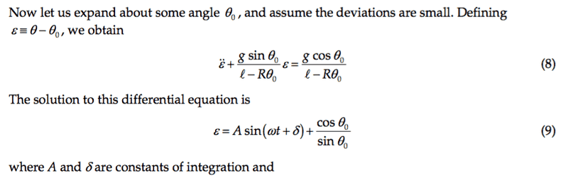

I mean to derive Eq. (8), I have to expand cosθ about ##\theta_0## (I understand this part) as well as taking -R(##\theta_0##')^2 to be zero. (this is where I lost it)
As you noted, for small angles, you can neglect the term ##R \dot{\theta}^2## in the equation of motion because this term is of "second order" in small quantities.
Likewise, ##\theta \ddot{\theta}## may be replaced by ##\theta \ddot{\varepsilon} \approx \theta_0 \ddot{\varepsilon}##
I do not understand why ##R \dot{\theta}^2## can be neglected. Although, the angle deviation is small, does it imply that its time derivative is small too?
Also, if "second order" involving theta is neglected, why woudln'd θ¨θ be set to zero too?

Yes, the time derivative of ##\theta## will also be small. For small swings, the motion is approximately SHM. For SHM, ##\dot{\theta}_{max} = \omega \theta_{max}##.

##\ddot{\theta}## is a small "first-order" quantity. But ##\theta## is not necessarily small. ##\theta \approx \theta_0##.

If we are taking an equation that's supposed to be valid over time and applying a small perturbation approximation then necessarily we are discussing the neighbourhood of an equilibrium point.
We know ##\dot{\theta} = \dot{\varepsilon}##.
We can estimate the order of magnitude of ##\dot{\varepsilon}## by considering an average value of ##\dot{\varepsilon}## to be ##\overline {\dot{\varepsilon} } \approx \varepsilon_{max}/T## where ##T## is the period of the motion. You could argue that we should use something like ##T/4## rather than ##T## in estimating the average, but we are just trying to get an order of magnitude.
So, by making the oscillations small enough, we can make ##\varepsilon_{max}## small enough that ##\overline {\dot{\varepsilon}}## becomes a small first order quantity. (##T## should not change much as ##\varepsilon_{max}## is made very small.) The maximum value of ##\dot{\varepsilon}## should be of the same order of magnitude as the average value of ##\dot{\varepsilon}##. So, ##\dot{\theta} = \dot{\varepsilon}## should be a small first-order quantity throughout the motion.
I'm not sure if this type of argument is rigorous enough to be satisfying. It seems to me that the physical setup is such that it is clear that small oscillations will be at least approximately SHM with small amplitude. Thus, the angular velocity ##\dot{\theta}## will also be small.
