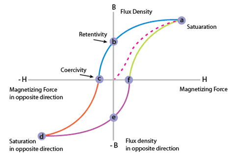

Another thing to note is that in engineering (especially industries related to permanent magnets/magnetism, like TDK), "permeance" is used as follows:
"in calculating a magnetic circuit, permeance P, which is the reciprocal of magnetic resistance R" ...
https://product.tdk.com/info/en/products/magnet/technote/designguide.html
"Permeance coefficient Pc is used to express the operating point of the magnet on the B-H curve. This value is defined as the ratio of magnetic flux density Bd and magnetic field strength Hd at the operating point."
Hysteresis loop graph of flux density B against magnetizing force H, with points a through f marking saturation, retentivity, coercivity and the opposite-direction saturation.

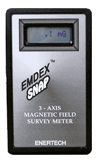

When measuring mag fields, one can use instruments such as [gauss meter]:
Handheld EMDEX SNAP 3-axis magnetic field survey meter by Enertech, showing the reading .1 mG on its small LCD display.
