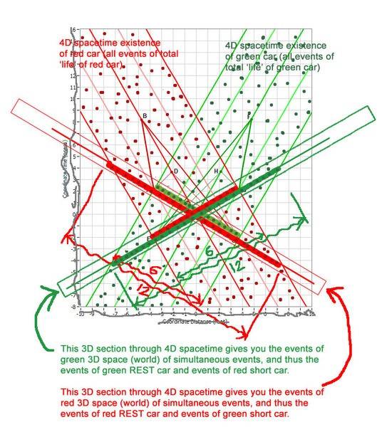

dvf said:
Nice diagram!
Fwiw, note that :
(*1) in the top figure, where Red touches the green car simultaneously with both hands, Green protests and says that Red is cheating because he does not touch his green car simultaneously. According to Green, Red touches the green car's front too late and the back too soon, so no wonder that Red thinks that the green car is shorter than the red car.
(*2) in the bottom figure, where Green touches the red car simultaneously with both hands, Red protests and says that Green is cheating because he does not touch his red car simultaneously. According to Red, Green touches the red car's front too late and the back too soon, so no wonder that Green thinks that the red car is shorter than the green car.
Fwiw? I think it's worth nothing at all. I do not like the way you formlate it. Sounds as if experiencing the shorter train is 'cheating' or 'incorrect thinking' of the observer train passenger. You get nowhere with this approach. No train passenger is cheating or thinking in a wrong way...

TheBC said:
I read a quite a few 'appears'/'appearance' vocabulary in this thread. Why should a moving train car 'appear' contracted (as if an optical illusion is involved), and not simply 'be' contracted? It does not make sense.
In the sketch I show how relative moving travellers experience reciprocally a moving contracted train car.
Unfortunately, a static sketch of a dynamic situation can lead to some false conclusions. Spacetime diagrams can clear up these false conclusions. Here is a spacetime diagram depicting the scenario you describe. The vertical red lines depict the red train car and its passenger. The endpoints of the train car are shown as the dark red lines on the left and on the right with another dark red line in the center showing the brain of the red passenger. The light red lines in between the dark red lines show the fingertips of the red passenger. Similarly, the long diagonal green lines depict the moving green train car and its passenger. The shorter darker red and green lines depict the signals traveling from the fingertips of each passenger to their brains. Note that each signal starts at the coincidence of a dark line of one color and a light line of the other color. I have chosen to make these signals travel at a little less than one-half the speed of light (44.7%c) just to keep the diagrams small enough to fit on a page although the same correct conclusions can be drawn no matter what their speeds are or even if they are different for each passenger (but the same for each arm of each passenger):
TheBC said:
The moving train car does not 'appear' to fit between the passenger's fingertips (and does not 'appear' contracted to be able to fit between his fingertips). The train car simply does fit between his fingertips. The signals (information of the events) of the front and rear of the moving train at his fingertips are traveling simultaneously, from his fingertips through his arms and reaching his brain simultaneously. That's no illusion or arbitrarily chosen frame calculation.
I agree it's no illusion but the statement that the two signals for each passenger are traveling simultaneously from their fingertips to their brain is based on an arbitrarily chosen frame calculation. In this case, it is true for the red passenger but not for the green passenger. And that is the point of length contraction. It is frame dependent. In the rest frame of the red train car, the green train car and its passenger are length contracted and his signals are not simultaneous except at the point where they become coincident at his brain. The fact that each passenger senses in his brain the two signals simultaneously (true for any frame) does not mean that the signals started out simultaneously at their two widely separated fingertips. The top image in your sketch shows only the instant that the two signals started out simultaneously in the rest frame of the stationary red car on the railroad tracks, in other words, at the Coordinate Time of zero in the above spacetime diagram. That image does not show how the signals propagate along the arms of either passenger on their way to their brains. In fact, it does not show where the signal is in the left arm of the green passenger nor where the green car is when the red passenger senses the two signals in his brain.
TheBC said:
There is a shorter train between the fingertips at the end of the passenger's arms. One may call this 'measuring from the passenger's frame'; it simply means what the passenger's 3D space of simultaneous events (his 3D reality at one moment in time) is made of.
If you consider a train car at rest in front of you, you do not say the train car at rest 'appears' x meters long. You don't do this because you do not refer to any 'optical illusion'.
Stating that a moving train car 'appears' contracted insinuates there is some optical illusion involved. But there is no optical illusion invoved. Therefore there is also no reason to state that a moving train car 'appears' contracted. If the moving train car 'appears' contracted, then a train car at rest also only 'appears' measuring a certain length.
The reason why people often think the contraction only 'appears' as such is because the contraction is reciprocal. How can relative moving train cars be contracted reciprocally if its not an optical illusion effect?

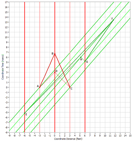

Because the 3D worlds of simultaneous events of both passengers are different. Consider the train cars as 4D spacetime structures instead of evolving 3D objects. The different contracted train cars are different objects of simultanous events, cuts with different 'direction' through the 4D spacetime train car structures (like cutting a loaf of bread in different directions results in different 'objects'/slices of bread). Minkowski or Loedel diagrams visualize this very well.

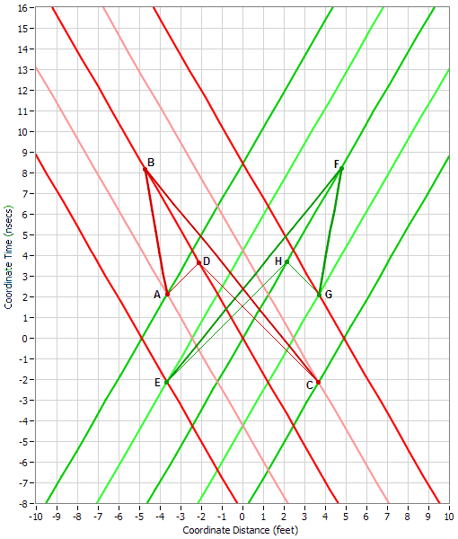

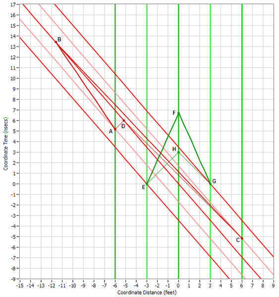

Now I want to show the above spacetime diagram transformed to the rest frame of the green train car and its passenger to show the reciprocal effects that you are talking about but first, I have to correct the bottom image of your sketch to show that the train tracks are also length contracted:
And here is the corresponding spacetime diagram. All of my comments regarding the rest frame of the red train car apply in a reciprocal nature in the rest frame of the green car:
And since you mentioned a Loedel diagram, I show another spacetime diagram transformed such that both trains are moving at the same speed in opposite directions:
The point of all these diagrams is that they are all equally valid and all depict exactly the same observations that each passenger and each object makes in the different frames. None of the frames are preferred, not even the rest frame of each passenger. In all of them, they each detect in their brains the signals from their fingertips simultaneously even though they may or may not start out simultaneously and may or may not travel along their arms simultaneously.
And as I said earlier, a static sketch of a dynamic situation can lead to false conclusions. If you had made animations showing the sensing by the fingertips of the opposing train cars and the propagation of each signal along each arm and the simultaneous arrival of each pair of signals in the brains of the two passengers, then the false conclusions could have been avoided. Your sketch depicts just one snapshot of such an animation.

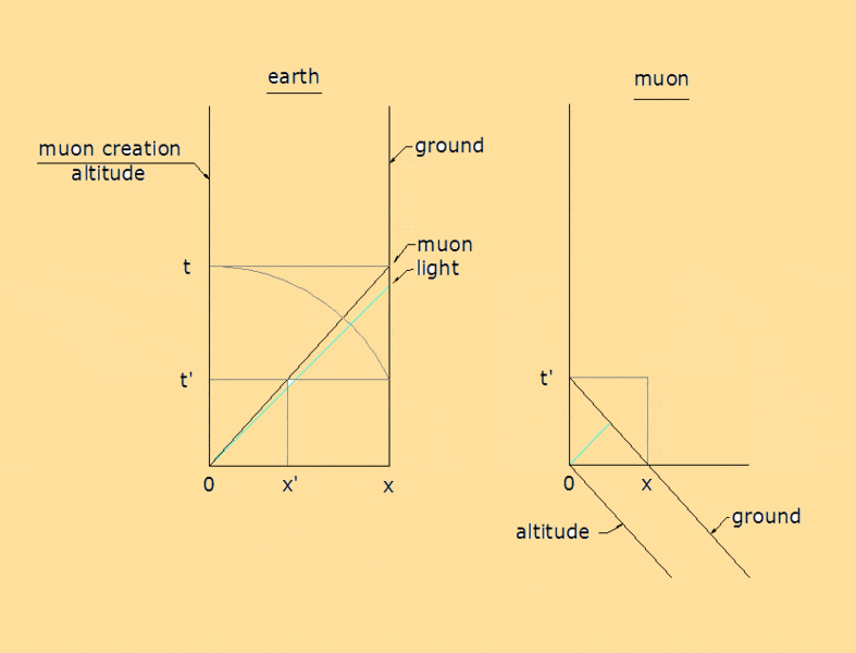

The reason I think, that K.E despite being frame variant is not referred as apparent is because it has physical consequences, like more energy would do more work.
Another reason would be the way LT is used to explain the physical results, for-example Earth-Muon system, that is one can get curious, that why is that in Earth frame the space is not contracted(instead it is usually explained as the muon being time dilated).
I think everyone here agrees that the two frames(Earth and muon) are just as the picture in post #59, so why do we even bother about muons being time dilated, instead one can simply understand that in both frames it was the space that contracted. Just like the red train(let's say muon) and blue train(Earth) sees each other contracted.
I don't agree. You just said that in the Earth frame the space is not contracted (which is correct) and then you say that in both frames the space is contracted (which is not correct).
In the Earth frame, the muons are the only things that are moving and the only things that are length contracted (but it doesn't matter) and the only things that are time dilated (which does matter). In the muons' frames, the Earth (which doesn't matter) and the space (which does matter) are length contracted and are time dilated (which doesn't matter).
Maybe the picture in post #59 gave you the wrong impression because it incorrectly shows the tracks not length contracted in both frames. I corrected that picture in post #70.

For Green the front and rear events are for him simultaneous simply because for him light signals travel equal path lengths in equal time. What Red thinks about those signales doesn't matter.
A real Loedel diagram shows this immediately. (I hesitate to put time in drawing one because Ifeel my loedel diagrams are not appreciated on this forum).
No one is going to object to a loedel diagram. Just take my last frame diagram and add whatever you want to make it a real loedel diagram. Just don't think that it is any more preferred or contains any more information than any other diagram for any other frame.
TheBC said:
I don't care about the train tracks. It's about the two cars. I didn't even mention whether one of the cars is at rest on the tracks or not, because that's irrelevant in this exercise.
Maybe you don't care about the train tracks but they apparently led someone else astray. You did show in one case that only one car was moving and in the other case that only the other car was moving and the tracks remained the same in both cases. As such, your pictures indicate two different scenarios that don't show the reciprocity of a single scenario viewed from two different frames.

Mentz114 said:
In the case of the muon trajectory, the observed facts that everyone can agree on are the
1. decay time measured by on the muons clock (t)
2. the same interval measured on the Earth clock (T)
3. the relative velocity between muon and Earth (β=v/c)
4. the distance traveled in the Earth frame (X)
The first three are frame invariant.
In the Earth coordinates X=vT and in the muon coordinates x=vt, where x is the length the muon 'observer' would measure for the distance.
Where's the problem ?
The reason that, we have to apply Lorentz Transformation to the observed facts in-order to get the explanation of how muon reaches Earth in it's frame, does not justify in anyway, why there is contraction only in the muon's frame. And if one claims it is a fair justification, then it is rather a justification of the applicability of LT to situations like this.
universal_101 said:
It was inquisitive, why is the space in Earth's frame not contracted ?
Since, there is NO difference between the two frames, one sees the other moving i.e. the situation is exactly symmetrical, there is nothing to choose between the two
How do you get to choose ? which frame sees space contracted, there is not a single difference between the Earth frame seeing muon moving and Muon frame seeing Earth moving. So again, how did you get to choose which frame experience what ?
In the muon's frame the Earth is time dilated and length contracted. The fact that the Earth is time dilated is irrelevant. The fact that the Earth is length contracted explains how the muon reaches the ground.
In the Earth's frame the muon is time dilated and length contracted. The fact that the muon is length contracted is irrelevant. The fact that the muon is time dilated explains how the muon reaches the ground.
It isn't a matter of choosing between the two, nor a matter of some supposed difference between the frames. It is simply a matter of identifying which effects are relevant to explaining the outcome in each frame. All the relativistic effects apply equally, but they are not equally relevant to the explanation.
