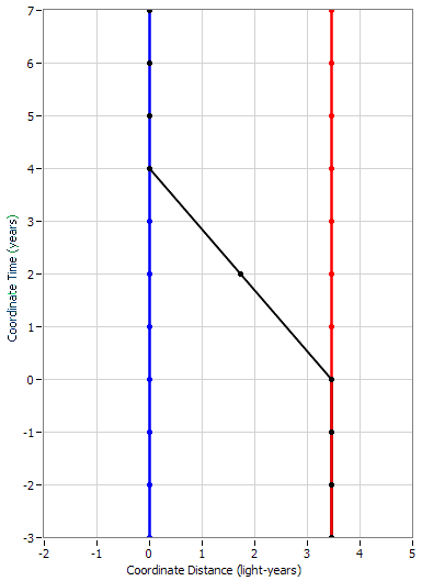

First, we have a spacetime diagram for the original rest frame of the Earth/Star/Astronaut. The Earth is depicted in blue, the Star in red and the Astronaut in black. The dots represent one-year increments of time for each body. Since the Astronaut is colocated with the Star at the beginning and with the Earth at the end, I simply show black dots on the other body's colored lines during those intervals:
Spacetime diagram in a single inertial frame: vertical blue line at distance 0 (Earth), vertical red line at about 3.46 light-years (Star), and a black diagonal from Star at time 0 to Earth at time 4 years, with dots at one-year intervals.
There are several things to note:
1) The distance between the Earth and the Star is 3.46 light-years.
2) The speed of the Astronaut once he leaves the Star is 0.866c.
3) At the Coordinate Time of 0, the Astronaut leaves the star and arrives at the Earth at the Coordinate Time of 4 years.
4) During the trip, the Astronaut ages by 2 years.
5) The Time Dilation factor at 0.866c is 2.
6) The Doppler factor at 0.866c is 3.732.

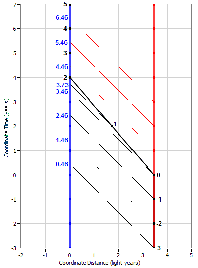

Now we want to determine what each observer actually sees. We do this by drawing in light signals propagating along 45-degree diagonals starting at one body and ending at another one. First, we'll do this for what the Earth sees:
Spacetime diagram with coordinate distance in light-years on the horizontal axis and coordinate time in years on the vertical axis; blue vertical line at distance 0 and red vertical line near 3.46, with black diagonal worldline from red line at time 0 to blue line at time 4, plus labelled diagonal light rays.
Note that since the Star is 3.46 light-years away from the Earth, the Earth observers will see the Star as it was 3.46 years ago. This means that even though the Astronaut leaves the Star at the Coordinate Time of 0, the Earth observers do not witness this fact until 3.46 years later.
Then they start seeing the Astronaut travel in high speed toward them. They also see the Astronaut's clock running 3.732 times faster than their own so that from their time of 3.46 years to 4 years, a difference of 0.54 years, they see the Astronaut's clock progressing through 2 years. This matches the Doppler factor if we divide 2 by 0.54.
Note also that during the travel interval, the Earth observers see the Astronaut's clock gain 2 years while theirs gain 0.54 years for a net gain of 1.46 years so now the Astronaut's clock is only 3.46-1.46 or 2 years earlier than theirs. However, they continue to see clocks on the Star at 3.46 years earlier than their own.

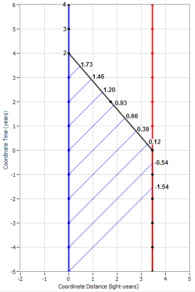

Next we want to determine what the Astronaut sees. Here's a spacetime diagram showing the light signals coming from the Earth to the Astronaut:
Prior to departure, the Astronaut sees the Earth's clocks 3.46 years earlier than his own (just like the Earth saw the Astronaut's clock). But while he's traveling, he sees the Earth's clocks running 3.732 faster than his own so that during his 2-year trip, he sees the Earth's clock go through 7.464 years. At the end of his trip, the Earth's clocks have gained 5.464 years compared to his own so that instead of being 3.46 years behind his, they are now 2 years ahead of his and they remain that way for the rest of his time on Earth. (The times for the Earth and the Star are the same as the Coordinate Times in their rest frame.)

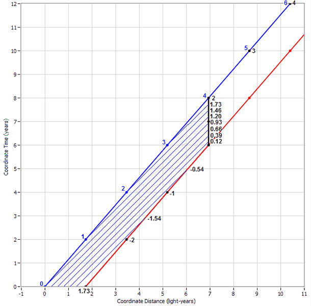

Finally, we want to see what things look like in the rest frame of the Astronaut while he is taking his trip. Actually, since it's his rest frame, it's the Earth and Star that are traveling:
Spacetime diagram with coordinate distance in light-years on the horizontal axis and coordinate time in years on the vertical axis; blue Earth worldline and red Star worldline, with numbered yearly dots and blue light-signal lines drawn at 45 degrees between them.
This diagram has the same numbers as the previous diagram but it shows that the distance between the Earth and the Star is contracted to 3.46/2 = 1.73 light-years as indicated at the bottom of the diagram.

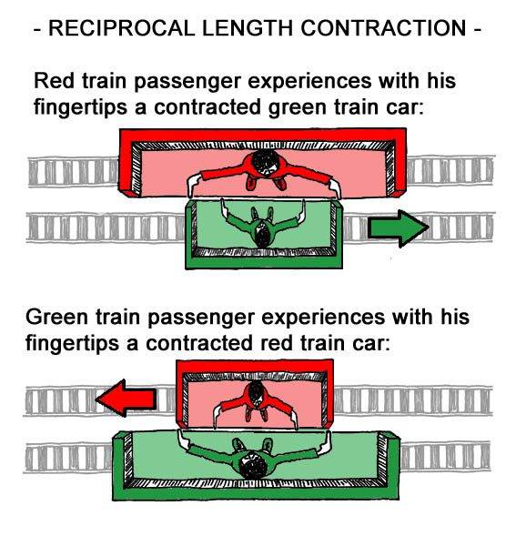

Could you please explain just the most fundamental basics on why length contraction occurs, and in what cases it can be observed or factored into a reference frame?
Although no observer can see length contraction, they can use radar techniques to determine what it is according to their own rest frame. I explain this in a similar scenario in this thread. Have a look and see if it helps.

I didn't say the astronaut could see that distance as contracted, I said we could see it. No observer can see either length contraction or time dilation as these are different in different frames and different frames will always depict the same experiences for all observers.
Can you explain a little bit further what you mean by "no observer can see length contraction or time dilation"?
I get that the traveler would not see himself or his own frame's length contract, but he could (potentially, in my imagination) witness contraction of lengths in front or around him, no?

Time Dilation and Length Contraction are frame dependent. When you transform events marking time intervals or lengths, they can take on different intervals or lengths. But the observers cannot directly see these effects. Every frame must depict all observations of all observers in exactly the same way.
If you go back to post #3 and study the first and last diagrams, you will see that in the first one, only the black astronaut's time is dilated while in the last one only the blue Earth's and red star's time is dilated. And in the first diagram the distance between the Earth and the star is not length contracted but in the last diagram it is. And yet in all the diagrams, I show how everything all observers can see and all their measurements remain the same. In order for an observer to determine any Time Dilation or Length Contraction, they must make some Doppler observations, make some radar measurements, assume that the outgoing radar signals take the same amount of time is the returning echoes, and then do some calculations and from this, they can determine what the Time Dilations and Length Contractions of other observers/objects are in their own rest frame. Furthermore, then can then transform to any other frame moving with respect to their own and see what the Time Dilations and Length Contractions are in these other frames, including frames in which their own time is dilated and their own lengths are contracted.

Diagram titled 'Reciprocal Length Contraction' with two panels: a red train car contracted around a green-clad passenger's outstretched fingertips, and a green train car contracted around a red-clad passenger's fingertips, each car moving in the direction of an arrow.
I read a quite a few 'appears'/'appearance' vocabulary in this thread. Why should a moving train car 'appear' contracted (as if an optical illusion is involved), and not simply 'be' contracted? It does not make sense.
In the sketch I show how relative moving travellers experience reciprocally a moving contracted train car.
The moving train car does not 'appear' to fit between the passenger's fingertips (and does not 'appear' contracted to be able to fit between his fingertips). The train car simply does fit between his fingertips. The signals (information of the events) of the front and rear of the moving train at his fingertips are traveling simultaneously, from his fingertips through his arms and reaching his brain simultaneously. That's no illusion or arbitrarily chosen frame calculation. There is a shorter train between the fingertips at the end of the passenger's arms. One may call this 'measuring from the passenger's frame'; it simply means what the passenger's 3D space of simultaneous events (his 3D reality at one moment in time) is made of.
If you consider a train car at rest in front of you, you do not say the train car at rest 'appears' x meters long. You don't do this because you do not refer to any 'optical illusion'.
Stating that a moving train car 'appears' contracted insinuates there is some optical illusion involved. But there is no optical illusion invoved. Therefore there is also no reason to state that a moving train car 'appears' contracted. If the moving train car 'appears' contracted, then a train car at rest also only 'appears' measuring a certain length.
The reason why people often think the contraction only 'appears' as such is because the contraction is reciprocal. How can relative moving train cars be contracted reciprocally if its not an optical illusion effect?
Because the 3D worlds of simultaneous events of both passengers are different. Consider the train cars as 4D spacetime structures instead of evolving 3D objects. The different contracted train cars are different objects of simultanous events, cuts with different 'direction' through the 4D spacetime train car structures (like cutting a loaf of bread in different directions results in different 'objects'/slices of bread). Minkowski or Loedel diagrams visualize this very well.

ZZ Specs said:
You explain that the Earth would see the astronaut leave at time = 3.46 years, and then see him arrive at time = 4 years. So the Earth witnesses the astronaut travel 3.46 light-years over the course of .54 years; wouldn't the astronaut then, from the Earth's viewpoint, *appear* to move faster than the speed of light?
Thank you all so much for your time and help. I excitedly look forward to a further understanding of the wonderful universe around us.
Knowing the image of the launch left simultaneously with the ship, when the image arrives, the ship should be close behind in this case.
The separation should be 3.46 yr * (1-.866) = .464 ly
Time to arrival is .464 ly/.866 = .536 yr.
The difference in travel time for light t1 and the ship t2, cannot equal t2.
t2 - t1 ≠ t2, since light has a finite speed. (ref: Ole Romer, James Bradley)
Since .536 is not the total trip time for the ship, it does not move faster than c.
Even if light speed was instantaneous, then the expression would be true, but Earth would observe launch at t=0, and ship does not move faster than light.
