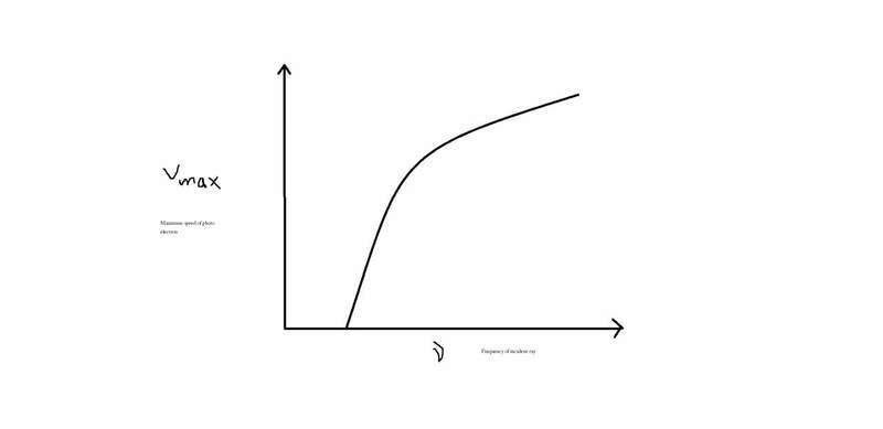

In what manner is max speed of photo electron dependent on the incident ray?
Could i see a graphical representation of it?
I thought it would be directly proportional but it isn't so.
Thank you

Thats what i thought too, but the answer of this problem is a curved graph. (see attachment)
There isn't an upper limit to the maximum velocity a photo electron can have right?

But speed is proportional to root KE, remember.
Right, KE is proportional to v^2, so v is proportional to the square root of KE.
There is, in principle, an upper limit to the electron speed, namely the speed of light (from relativity theory), but we're only dealing with a few electron volts of KE, which leads to speeds much too small for relativistic effects to be observed.

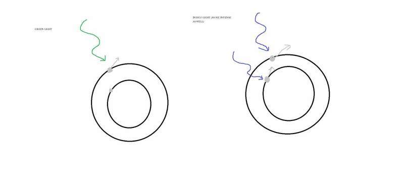

Imagine this situation, a metal plate, supposedly containing more than two shells of electrons, and a beam of green light incident on it is able to release the electrons.
If instead of the green light an intense indigo light is shone on the plate, can it release more electrons than the green light?

Wait, let me get this straight, the thing is if green light can remove electrons on the surface, indigo light with the same intensity or higher can remove more electrons, from deeper in the atoms of the metal?
(see attachment)

"deeper" is a bit too classical / intuitive a term. Electrons have all sorts of energies - some may be 'deeper' but happen to be traveling towards the surface. Others may be nearer the surface but traveling away. Some may be right next to a metal ion whilst others may be mid-way between a group of them. I don't even like those analogies but perhaps you'll see where I'm coming from on this; they would all have different requirements for energy to remove them. It's statistics at work and nothing like a hydrogen atom model (no 'simple orbitals', for a start).

Yes. The green light might remove electrons from deeper in the metal, but they will not have enough energy to "escape" the metal before it runs out of energy and is captured by the metal again. Higher frequency light COULD make that same electron posess enough energy to escape to the surface and beyond.
