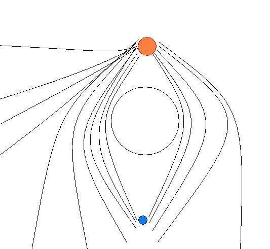

An object with an enormous amount of mass (black hole? antimatter? blackmatter?) is positioned smack in the middle of to other object, one being a star much like our sun, the other being a point where an observer stands. Let's just call it Earth at this time.
Now, while standing on Earth observing in a straight line towards the stars "absolute" position, these questions arise in my (strange) head:
1. would not the star be visible as a circle, since the light would bend around all "sides" the black hole before it reaches earth?
..and if you go one step further..
2. would not the star be visible as just a fog, a mist, of light, since the light would be bent in an infinite amount of angles around, and away from, the black hole?
I'll try to visualize it with some drawings:
Figure 1:
Light is bent around the black hole, hitting the Earth in an infinite number of places.

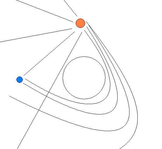

Figure 2:
Light is bent around the black hole, arriving at "two" (just to make it easier) different places, making it look like the same star was to places at the same time from the observers point of view.

Googling "Einstein ring" also turns up some nice pictures :)
http://blogs.nature.com/news/blog/einsteinring.jpg
atleast my first "theory" was correct (which i think is kind of fun since i haven't read anything about this before)
now for the matter of figuring out why light isn't scattered everywhere, making a light-emitting-object impossible to see..?
in my mind, when in presence of a black hole, everything should appear to be everywhere, since the release of the photon from the black holes gravitational pull (time/space warp) should be arbitrary/random, and would end up just so random.

As long as one doesn't get too close to a black hole, in gravitational terms it acts just like a normal star. In lensing one only needs general relativity without quantum mechanics, and light doesn't get captured and re-emitted, it just gets bent.
This thing about a black hole emitting photons randomly is probably a reference to Hawking radiation in which general relativity and quantum mechanics are considered together, and is about stuff that is captured and re-emitted.
