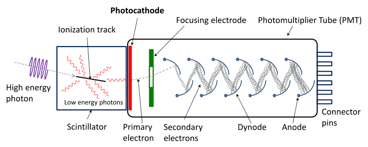

Or more mundane, how does a photon multiplier work? I thought individual photons passed into a chamber with photoelectric parts and held under electric fields to accelerate and multiply any electrons that come off?
https://en.wikipedia.org/wiki/Photomultiplier_tube
That's right. But just remember that an 'individual photon' really means a quanta of energy/momentum/other properties that an EM wave has.
