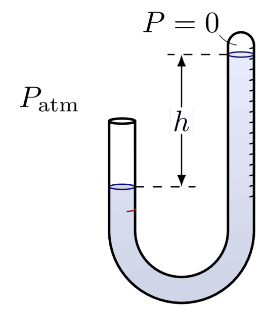

I think it might be easier to discuss if you refer to the picture below since you can clearly see which forces are balanced. Give it a try.
This one seems pretty obvious. We can see that atmosphere is pushing on the left free surface, while at the same elevation on the right side, hydrostatic pressure (caused by the weight of the fluid) is pushing and balancing it.
Could we make some analogy to Torricelli’s experiment? Some of the fluid will leave the tube, and the remaining will be balanced by atmospheric pressure acting from below (I guess), because the hydrostatic pressure of the remaining fluid won’t be enough to “push” upwards fluid in the bowl. So it reaches equilibrium.
I added “I guess” because the “acting in all directions” aspect of pressure is confusing me at the times even though it does make sense to me perfectly in the most cases
I think you have it. With the bowl it's just a bit more complicated since the surface area of the mercury in the bowl is different from the cross-sectional area of the tube, but the balance of forces acting on the column of mercury in the tube is exactly the same.
It's true that pressure acts in all directions equally, but for the mercury in the bowl the atmospheric pressure can only push downwards, which means it pushes the mercury column in the tube upwards.

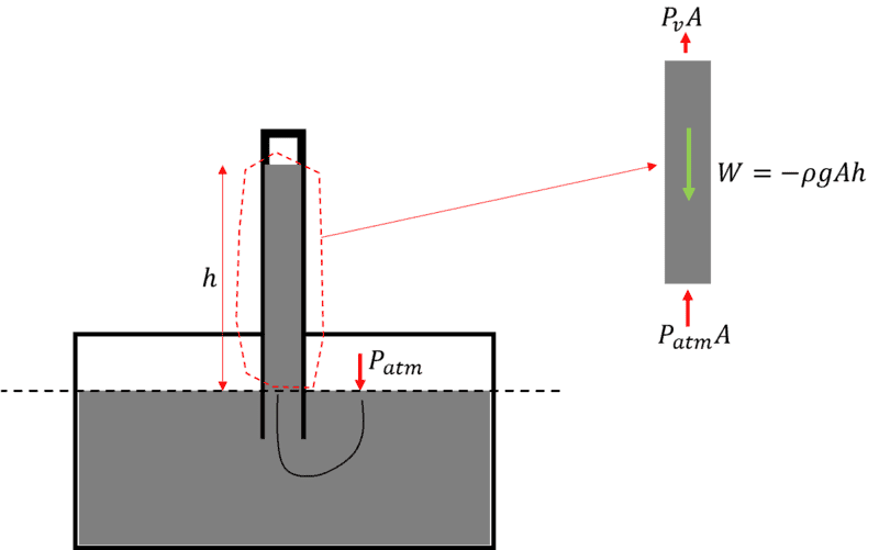

You need to do a free body diagram of the mercury column in the tube. From the free surface of the base to the underside of the tube you apply hydrostatic equation to find the pressure acting upward of the base of the column.
Sum the forces acting on the system under equilibrium:
$$ P_{atm} A - \rho g A h + P_v A = 0 $$
##P_v## is mercury vapor pressure (assuming tube was initially inverted without the introduction of air)
##A## is the cross-sectional area of the tube
## \rho## is the density of the mercury

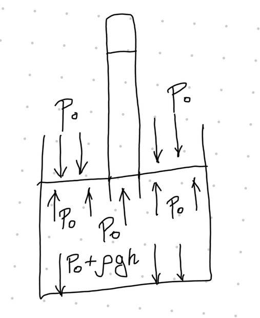

Thanks for effort. If I got it right, atmospheric pressure is acting in all directions inside the fluid? So that’s how it eventually balances hydrostatic pressure coming from tube:
(Sorry for poor illustration, I made it on my phone)
(Note: these aren’t vectors, these are just showing the direction of pressure).
Yeah, it looks like you understand. That’s why I drew that line going from the surface back up to the elevation of that surface. Between the two endpoints there is no hydrostatic pressure difference. We know the pressure at one of the endpoints …we deduce the pressure at the other to be equivalent.

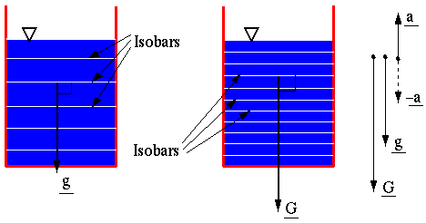

I recommend you to visualize isobaric planes for static fluid problems.
Unless the fluid is in movement and/or accelerating (other than vertically, as shown in the diagram showing fluid located inside an accelerating elevator), those isobaric planes, which contain all points with similar static pressure, will always be perfectly horizontal.
