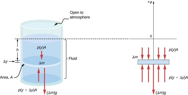

Diagram of a fluid column in a cylinder open to the atmosphere, with a thin slice of thickness Δy and area A, labelled p(y)A pushing down from above and p(y + Δy)A pushing up from below, plus (Δm)g downward; a free-body diagram beside it shows the same forces on the slice with +y axis and origin 0 marked.

The Static Pressure is an initial condition from the integration of the hydrostatic differential equation:
$$ \frac{dP}{dz} = - \rho g \implies P = -\rho g z + C $$
##C## is just an arbitrary boundary condition(or initial condition); Meaning to explicitly solve it we need to say what ##P## is at some particular ##z##.
