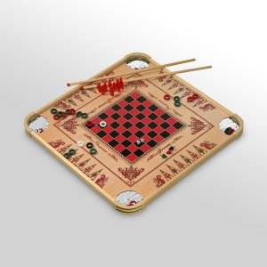

The physics of the game of pool is fairly complicated. You will need to include more things in your analysis if you want to get a moderately accurate model, IMO.
If you take the much simpler game of "Carom" shown below, can you see how it is simplified compared to pool/billiards? Since the reflections off the walls are mostly elastic, and there is no rolling of balls involved, the analysis is much simplified. What do you need to add into your pool analysis beyond the things you've already mentioned?
https://images.hayneedle.com/mgen/master:CM059.jpg?is=300,300,0xblack&cvt=jpg

Thanks Berkeman.
Before I have thought about whether the density of the wall/rail/object will affect the momentum conserved after collision, I have also though of whether the amount of force applied to a ball will affect the type of collision that will occur when the ball hits another ball. I just thought that the force can be controlled with a spring.
Also, it seems like I can work with Carom too :D
