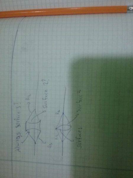

But, how do I choose surface one and 2?
Surface 1 has the lower x coordinate of you're using the ##(1/r_1-1/r_2)## form. It doesn't matter if you're using the other form.
Keep in mind a simple case, such as a biconvex lens. You know that f is positive. That let's you make a workable choice for convention: both positive and use ##(1/r_1+1/r_2)##, or surface 1 positive and 2 negative and use ##(1/r_1-1/r_2)##. Then you can flip signs as appropriate for the surfaces of the lens you actually have.
Correct? The surface 1 is then the firSt thwt the light hits
It's all just convention. Usually light rays enter the system from the left, moving to the right, which is the +x direction. And curvatures are defined as positive if the inside of the curve is on the +x side of the surface. And ##r_1## would be the radius of the first surface. In that case, yes you are right.
But I advise you to keep a simple case (e.g. a symmetric biconvex lens) in mind and figure out the signs as you go. With the symmetric biconvex lens you know that the two ##1/r## terms must end up with positive signs somehow (either because the radii have opposite signs and the two terms do too or because the two terms have the same sign and so do the radii) because otherwise the power is zero.
Then you won't be fooled by people picking different conventions.
