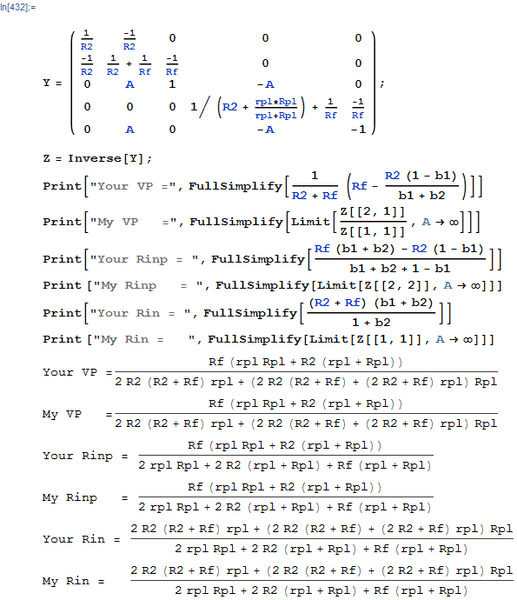

I've verified your derivations associated with Figure (5). I used b1 and b2 to represent your feedback factors β+ and β-. It would be trivial to get the expressions for the case where A is finite, including where A has a rolloff with frequency, such as a single pole rolloff.
Hi Electrician
Thank you for verifying my other equations on Rin and Rinp. Now I feel a lot better. I never studied linear algebra, so it'll take me a little time to read your matrix.

Here's a good exposition on how to set up an admittance matrix by inspection: http://web.ecs.baylor.edu/faculty/grady/EE411_Fall2011_Week_02.pdf
Here's the step-by-step setup using opamps: https://forum.allaboutcircuits.com/threads/admittance-matrix-for-fliege-notch-filter.112366/#post-869823
Shekel's method using an admittance matrix as I've shown in this thread doesn't require deriving expressions for impedances at various internal nodes. The transfer function just falls out naturally.
The very last part of your work shown in the attachment of post #3 adds a vacuum tube with transconductance gm and plate load RL. Adding this to the circuit of Figure (5) is easy; all that is required is the addition of one row and one column. The resistor R1 is changed from R1 = R2 + rpl || Rpl to R1 = R2 + rpl || RL to maintain balance. A grid resistor Rg is added to prevent the matrix from becoming singular, but Rg doesn't appear in the output expression if the grid is driven from a voltage source.

To show the power of Shekel's method, suppose you wanted Vod/Vin with a finite opamp gain A. In an instant I can get that result:
Or perhaps you would like to know VP:
Look how much more complicated the expression for VP is for finite opamp gain A:

No, it's just using a so-called mathematical assistant program to do the tedious algebra involved in the matrix arithmetic. I'm using Mathematica, but there are others such as Matlab, Mathcad, Maple, Macsyma, etc.
